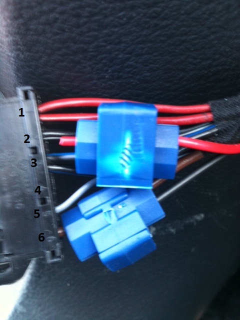

possibly a silly question, but dont have time to search it, could anybody tell me what colour wire goes to the reversing lights? thanks
I wired mine into the left side and on that side it is the black/blue wires (There is 2 Black/Blue wires going into the same socket), either wire will do.
I think it was the 3rd socket down they went into.
Also its not a silly question, rather than look it up myself I borrowed a mates multimeter and looked for the 12v when reverse was selected B)
