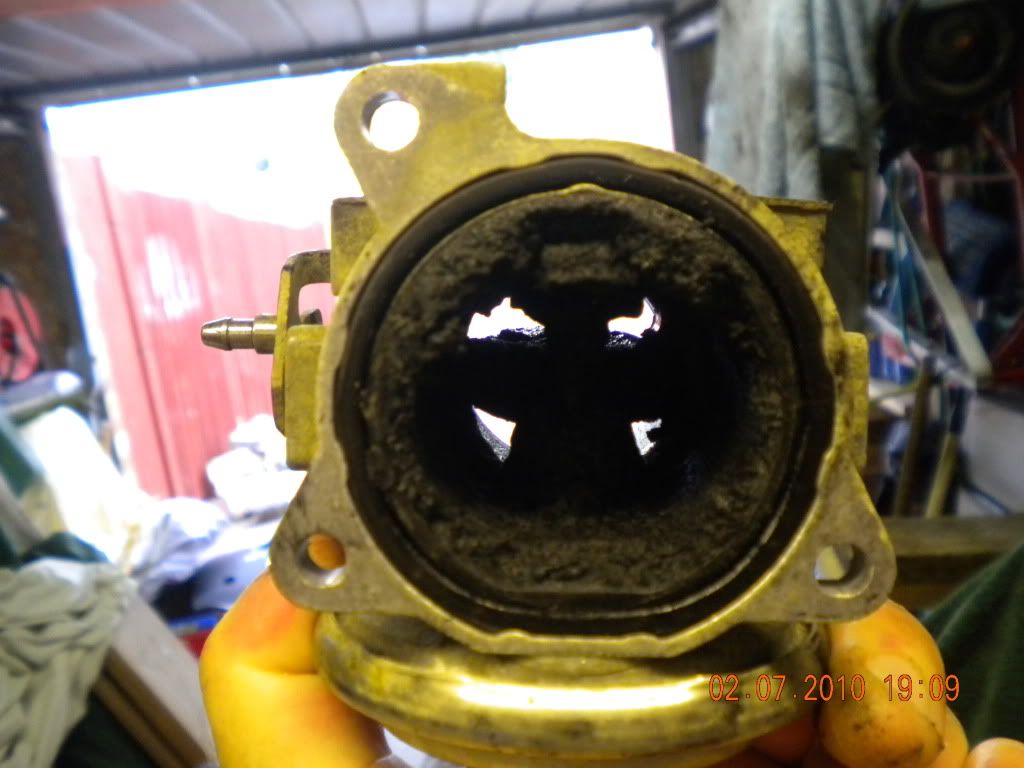

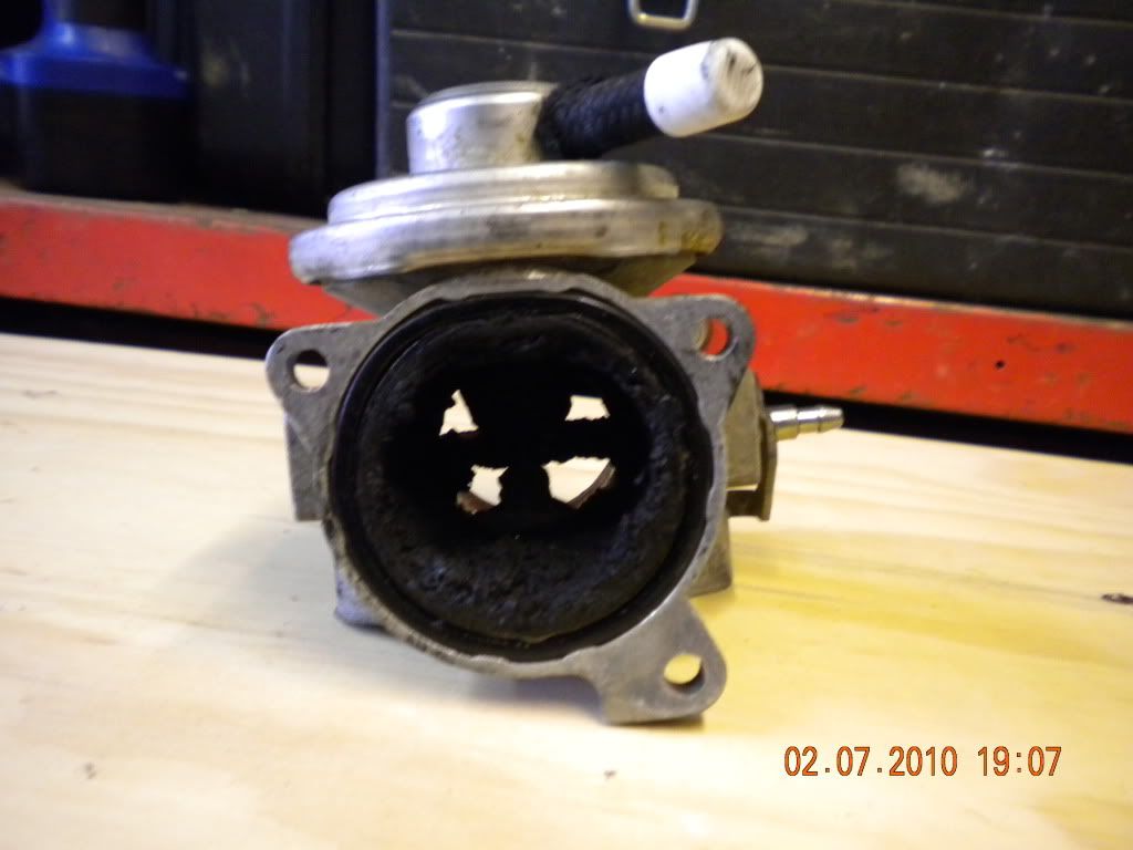

Ok, finally cleaned it tonight, scraped the worst off with a screwdriver, the placed it in a container, soaked some rags in white spirit, stuffed them inside the egr and let soak for 15 minutes, brushed with stiff toothbrush, rinsed with WD40, dried with blue roll, rubbed with 120 grade sandpaper, rinsed again with WD40, final dry with blue roll and refit - EGR delete now complete, just need to take it for a run to see if there is any difference.
Before.............
[IMG]http://i199.photobucket.com/albums/aa39/alexandjen/Octavia/EGR%20Cleaning/EGRCleaning004.jpg[/IMG]
[IMG]http://i199.photobucket.com/albums/aa39/alexandjen/Octavia/EGR%20Cleaning/EGRCleaning001.jpg[/IMG]
After................
[IMG]http://i199.photobucket.com/albums/aa39/alexandjen/Octavia/EGR%20Cleaning/EGRCleaning008.jpg[/IMG]
[IMG]http://i199.photobucket.com/albums/aa39/alexandjen/Octavia/EGR%20Cleaning/EGRCleaning006.jpg[/IMG] Edited by alexandjen

[quote name='alexandjen' date='03 July 2010 - 00:01' timestamp='1278111686' post='2031145']
[/quote]
My my, that was nice and dirty! I have cleaned mine twice in my 167k miles and fortunately it has not looked that bad :wonder:
