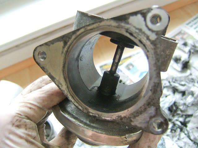

Quick question: my Octavia flew through the MOT last Friday, and passed the emissions with one single rev on the machine, giving a reading of 0.84.
Would there be any benefit at all to clean out the EGR valve? There's no sign of any rough running or poor economy, no engine light on, no nothing. Just wondering if cleaning could improve things to even better that things are.
Or is it very much a case of "if it ain't broke, don't fix it".
It's a 1.9PD, BJB engine,now with 53k miles on it, and the EGR valve has never been off.
Thanks
Mike

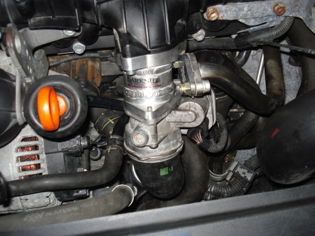

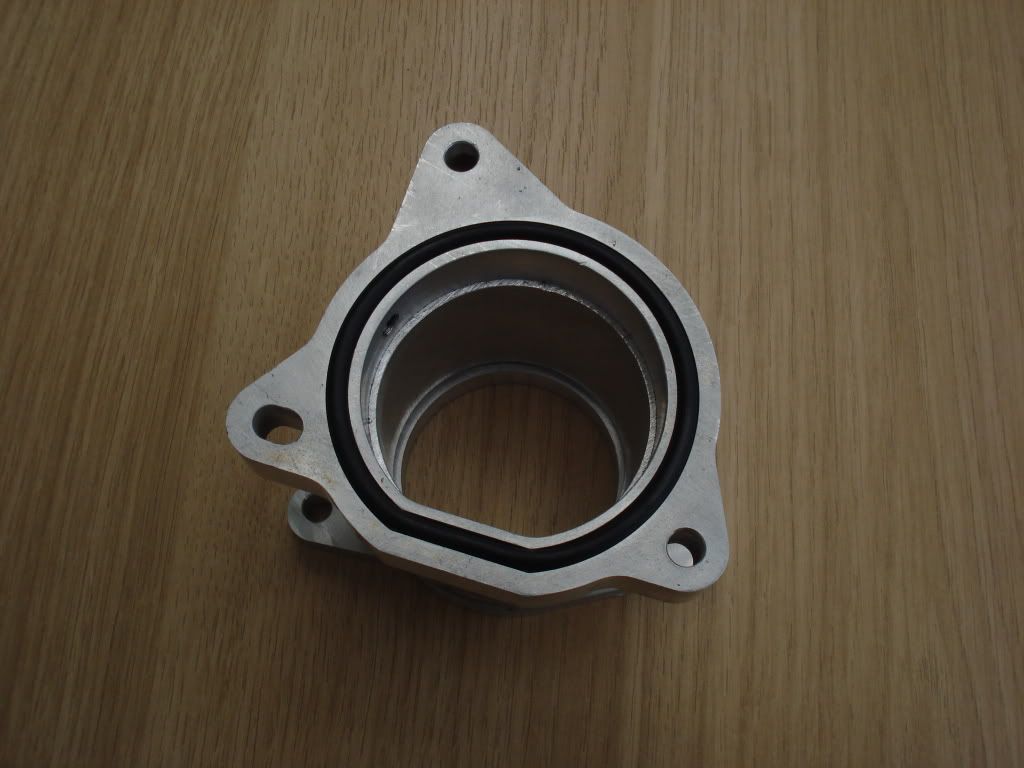

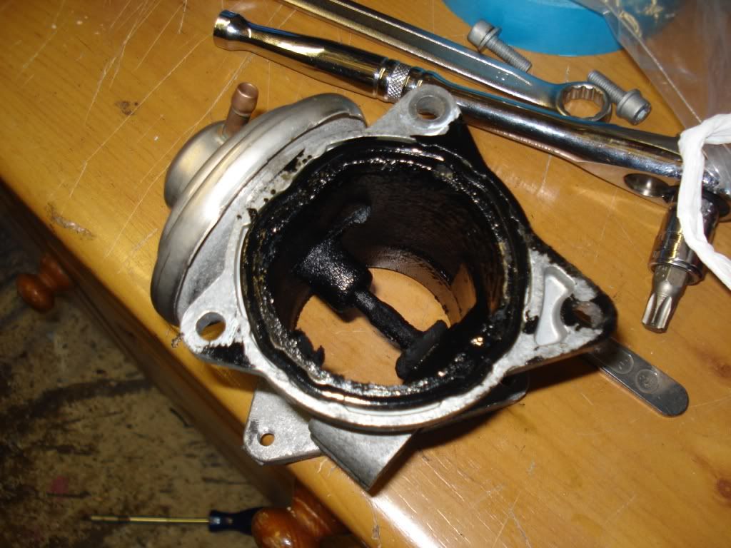

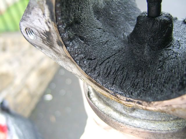

Here are some pictures to illustrate a bit better.
My OE EGR valve -
Posted Image
Delete pipe -
Posted Image
Fitted -
Posted Image

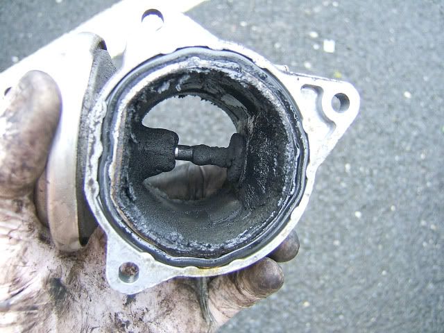

Mine had covered a little over 45k, and tbh wasn't that bad, the last picture is from a vehicle which had covered less miles. Poor servicing, fuelling and enviroment can all play a part in how bad they can get. Imo, for 70 quid it's a no brainer, as I noticed increase throttle response and over a couple of runs the mpg increased slightly.
Posted Image
HTH, Lee.

Posted 08 September 2011 - 12:40
That picture is ridiculous! It's any wonder the engine still functioned! And at that, I'd be surprised if the flap control was working even slightly, with that amount of build-up.
Despite the short comings of the EGR system, and its tendency to clog up, it's not the fault of the system that it's ended up like that. That'll be incorrect servicing intervals (if any at all!) and perhaps even the incorrect oil spec being used.

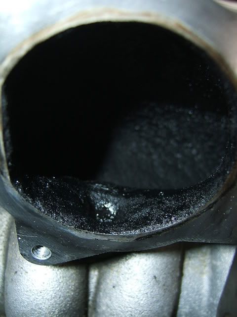

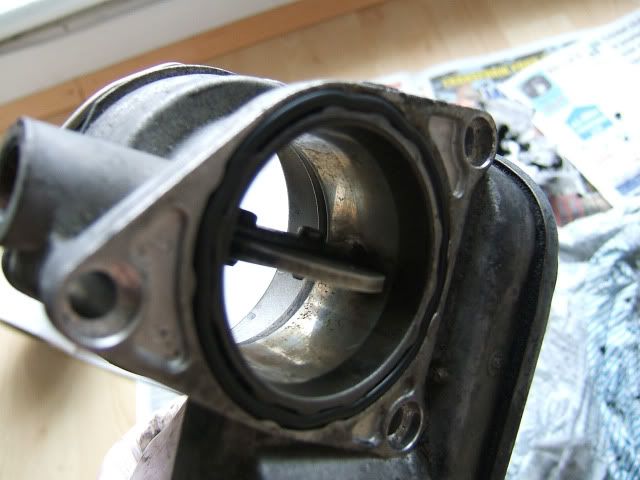

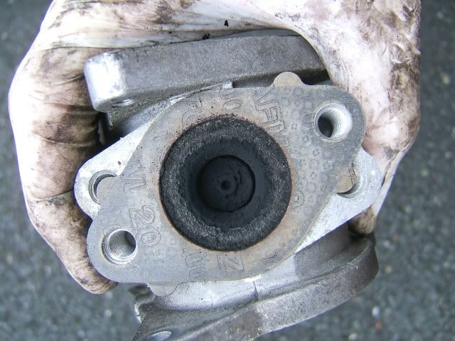

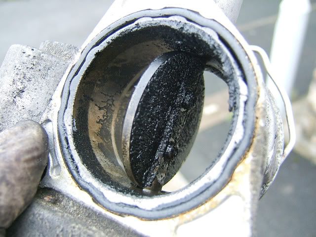

OK, having had a good look at the EGR valve on the Octavia, and having had advice from Lee (Pagey), I've decided to leave it well alone. I couldn't see any way of accessing the bolts, so I took the rubber pipe of the end, and looked inside to find it wasn't actually bad at all, not even as bad as Pagey's in post 5.
However, the idea of cleaning the EGR got me intrigued as to what it was like on the Leon (1.9TDI, ASV engine, non PD). This was easy to take off, and I was horrified to find it probably 40% caked up with black sludge, worse in fact than the last photo in Pagey's post. Sorry there's no photo, but I wasn't touching my camera with my hands in the state they were!
It took nearly a full can of carb cleaner to remove all this, but it has all come out, and the difference in the way the car is running is tremendous. It's far more pokier, revving more freely, and seems a lot quieter as well. So a big thanks to Lee for all his help on this.
I'm just thankful that the Octavia isn't in the same state -- possibly because I use nothing else but Texaco or Shell fuel, never supermarket stuff. But I'm not opening that discussion again! Makes me wonder, though...........
Mike

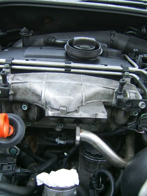

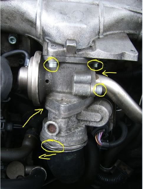

The 2.0 PD is probably easier as it's at the front of the engine.
You'll need a 6mm and a 5mm allen key and if you've got a set of allen keys on sockets, then that with a ratchet helps.
You'll also need a fairly wide flat headed screwdriver to allow you to pop the clip open on the bottom hose of the EGR/Anti-Shudder valve.
Finally some carb cleaner, a couple of pairs of rubber gloves (disposable), a fair amount of kitchen roll and some old newspaper.
A few cocktail sticks and an old toothbrush prove to be helpful too.
1) unplug the electrical connector and carefully place it out of harms way.
2) Use the screwdriver to slide it behind the spring clip on the large lower hose connection and pull to open the spring lock.
Once this is open (Taking care not to damage anything) then you can slide the hose out of the bottom and clean up any oil that leaks out.
3) Using the 5mm allen key, undo the long bolt at the rear (slightly left) of the EGR/Flap body.
4) Undo the two 6mm allen bolts attaching the EGR feed pipe on the body and put these in a safe place.
5) Undo the two short bolts that hold the top of the EGR to the inlet manifold.
Don't bother separating the EGR and flap as it's probably not needed.
6) Remove the section, and clean it all out carefully, making sure you don't damage anything and don't try and force the flap.
The flap won't move, so don't try as doing so will break it.
7) Refit everything in reverse, using new gaskets if required and a small amount of threadlock on each of the removed bolts.

EGR and IMF cleaning for the 2.0 PD. Pics from the BKD engine.
Remove the plastic engine cover first
Unclip the large circle clip from the bottom of the Intake Manifold Flap [IMF] (bottom circle in this pic) by using a flat head screwdriver or pliers (mine didn't need to come fully out). Then pull the black intake pipe down and out of the IMF housing.
Unplug the IMF electrical connector (right). Unplug the EGR vacuum pipe (left):
Posted Image
Undo the allan bolts in the above picture next. There will be three (2 short and one long) which hold the EGR and IMF to the intake manifold.The last one around the back is arrowed on the left.
Then I needed a star bit to remove the EGR feel pipe bolts (2) which are the bolts to the right of the picture. The one behind is hidden in this picture and again arrowed.
The whole assembly will then come out. I actually also undid the other 2 allan bolts to separate the EGR from the IMF.
You will be left with this gaping hole:
Posted Image
Then it's time to get dirty and clean:
EGR at 110k
Posted Image
IMF at 110k
Posted Image
Intake Manifold
Posted Image
EGR Macro
Posted Image
Posted Image
Clean enough
Posted Image
Posted Image
Then when you are filthy and you have covered all your clothes, shoes, drive and carpets in soot and oil put it all back in reverse order.

After that you can decide whether you want to put this gasket in too:
http://www.briskoda....s/#entry2958515
Posted Image
Picture stolen from this post:
http://www.briskoda....problem-solved/
Edited by Plantman, 19 October 2012 - 13:28.

Just for info - heres a couple of links to a new EGR and the EGR delete from Darkside:
New EGR - http://www.darksided...131-501-an.html
EGR Delete - http://www.darksided...-race-pipe.html
