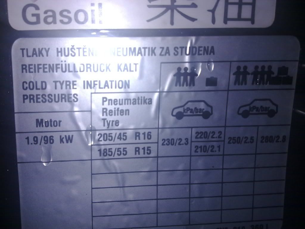

Posted 27 December 2011 - 20:42
Have a look inside your fuel filler cap!

Posted 27 December 2011 - 20:52
He is using VRS alloys on a lighter, non VRS.

Posted 27 December 2011 - 21:30
Here you go! Posted Image
Posted Image
