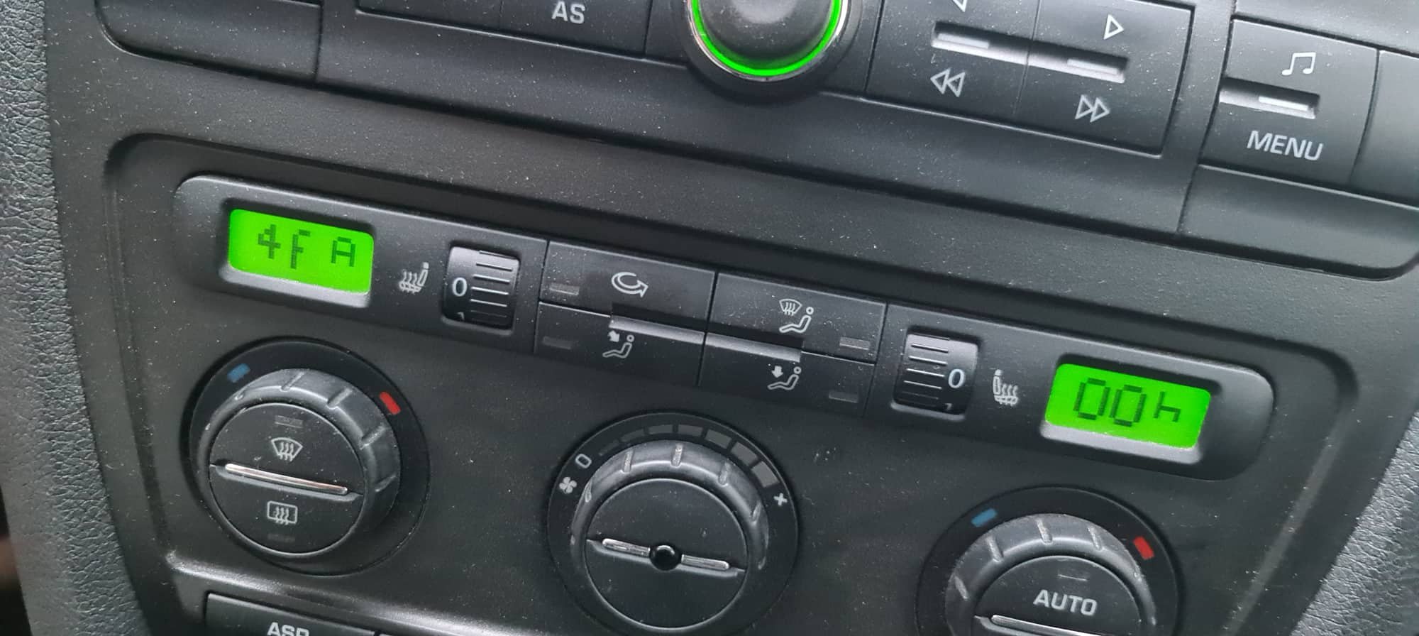

When you get the io on the screens if turn the
Knobs( can't remember which one ) it changes the screen. I get io as well as 02h 0E5 which I have no idea what it means. Have a fiddle with the dials and see if changes to a code. Also if you hold down the ECON and re circ button and use the left temp dial to change number to 19 and the middle dial to change number to 4 it should give the compressor speed in tenths. There is a thread on here somewhere about it I'll try finding it ASAP for you.

my aircon doesnt work either, had it regassed a couple of times over the 4 or 5 years ive had it (57 L&K) and its been lovely and cold for a week or so then warm again, so rather than regas a third time i thought id look into what may actually be the problem.  been reading the 'self diagnosis thread' too and have got the same codes as above, OE5 02h.  has anyone come up with the answer for this, do we know what these codes mean please?

I have a 56 L&K and am having a/c trouble again. Less than 2 years ago I had the compressor replaced and it was brilliant all last year. We've come to use it for the first time recently and got nothing but ambient air. Ive done the self diagnosis thing and it shows 4CF 07h. Any ideas please
