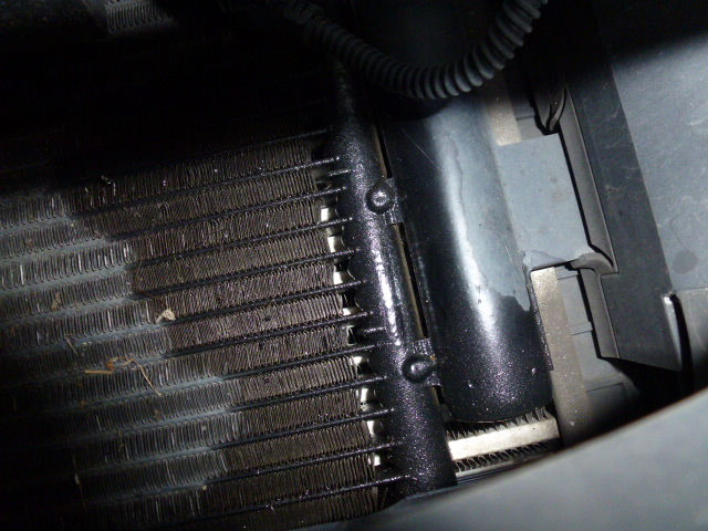

Happen to notice tonight that the yeti has a weep.
No damage so must be a failed joint, due a service in 1800 miles. so will see the vet tomorrow and book a early service and get them to see why its unhappy, and put a smile back on its face :giggle:

Looks like oil/diesel to me.
Can you see where it's coming from?
It may be air-con leaking, not sure about the mould though.

It's the engine oil cooler that has a very slight weep form the end, it's going in on Monday for a service and to be looked into, the rads are oil, then air con then water,
I'm confused - I thought one was the intake air intercooler and the "oil cooler" was an oil/coolant intercooler on the front of the block :think:

Mine is just coming up to 18k now (other half has less distance to travel to work than you) , noticed the weep when I took my grill cover off, and looking at the dust covering and the amount of oil it has been weeping for a while. There is a slight oil dampness on the join at the front of the engine under tray but no dripping so it may be hard to find, but under warranty so they will probably just put a new oil cooler in. Will let you know the outcome next week.
Not looked that hard but one may be a duel rad ( :notme: may be wrong). On all the large machines I have driven and maintained the oil cooler was always the first in line then air con and inter cooler then water, (could be different on the yeti but the weep is defiantly oil)
Yes there are three separate 'coolers' sandwiched together; front aircon, middle turbo inter-cooler and rear engine coolant. The oil cooler being the sardine tin shaped box on the front of the engine.
Often get a lot of oil mist in the turbo pipework (oil breather, bearing loss etc.) which will blow out of a faulty air inter-cooler akin to a oil leak.

Well it turns out that its the air con rad weeping failed weld, so new rad going in tomorrow.
Also the vet noticed that the auxiliary water pump was looking damp, so they are changing that as well (only added a little coolant after the first week or so when new), wounder how many dealers would have left it ? and then it fails out of warranty, which only has one year left to run.
