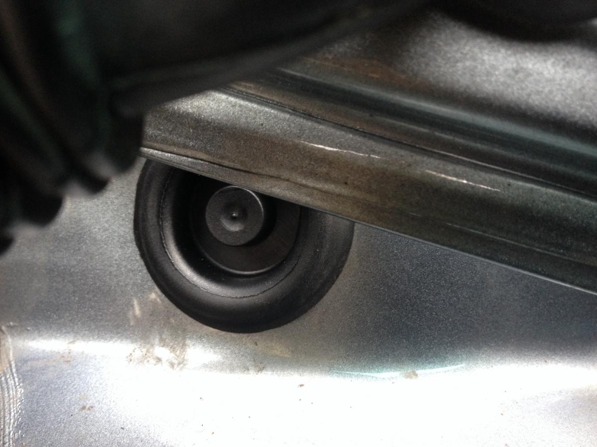

Well the car was with Preston Motors Škoda for three days. Turns out there was a bulletin on my car to replace the sunroof's rear drain pipes... Hmmm. Thanks for letting me know of this Škoda UK. Anyway they've been replaced (and the parts to this was the delay). I'm not convinced in the least since a few of you WITHOUT sunroofs had the same issue. We shall see. I have different style teets now out back.

Was thinking about this thread yesterday night, after I jet washed the car on the way into work. Noticed after that I seem to have a small leak inside the rear hatch window, from the top of it. Noticed a "trace" on the inside of the window when there were some lights behind me.
I shall mention it when the car is next at the dealers, but being out of warranty I suspect it is going to be a tube of Captain Tolleys!

On this topic, I got the same issue on my 2010 Yeti. In my case I guess it can be both sunroof (which I found leaking) and the sprinkler (I will check). Someone was mentioning that the newer yetis have a different drainage (down to the wheel arch). Does anyone has some pictures (not schematics) and the part numbers to do this conversion?
Thanks.

PM me your email address and I'll send you over the technical bulletin for the drainage upgrade,which includes the P/N
I had this done to my Yeti (but not at the dealer) and its cured the problem!
