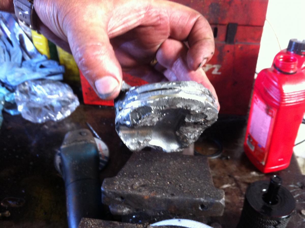

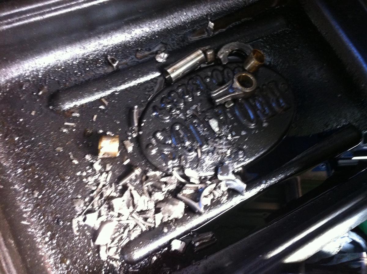

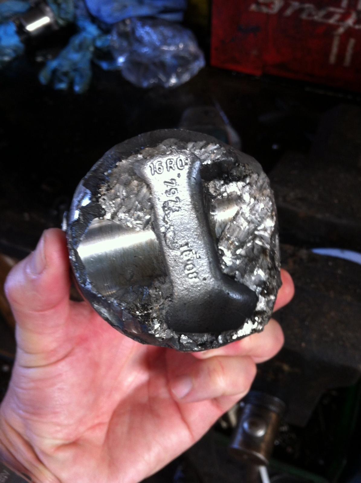

The last time I visited my mechanic mate, he was rebuilding 1.9 BXE engine from a VW Passat which had thrown a conrod. It had done less than 50k miles. He had bought it cheaply from a main dealer and tells me the engine was still running despite what he was faced with when he stripped it down. Have a look at the attached photo's you'll be amazed it was still running!

Had a 2008 1.9TDi Octavia as a company car. at 4 years old and 110,000 I bought it as my private family car.
While as a company car, it was on a variable schedule, roughly every 18,000 miles.
After I bought it, the car was serviced by a Nissan dealer who, unbeknown to me at the time, used the incorrect oil.
6 months later, it threw a conrod!
Despite proof in the service record that the incorrect grade of oil was used, there was little point pursuing it as it would have cost more to try and prove the oil caused the failure on a >100,000 mile engine. Got some money back for it though as it was an Elegance , which I speced up with Xenons, Cream Heated Leather, seats, TPM, OEM Bluetooth (fitted as a kit, not available as an option in 2008), Columbus Sat Nav and DVD Players in the Headrests. it was a £20K car in 2008.
