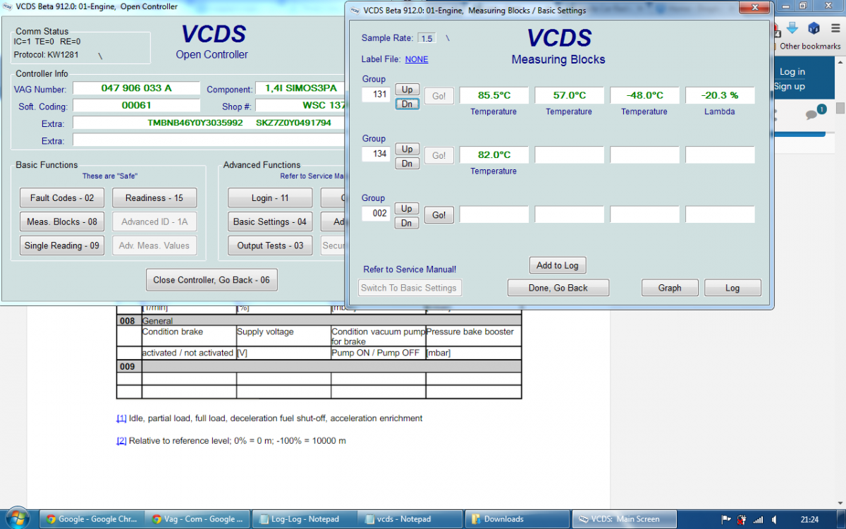

Do you have any idea if a MK1 Fabia with a 1.4mpi engine, ATZ model has an F265 thermostat, mapped engine cooling device, beside the regular, mechanical one ? I've been playing with VCDS this evening and on measuring blocks, I've reached group 0132 (yep, I got borred) and for some reasons, the reading there was -48 Celsius degrees, which I don't think it's accurate (today were about 30).
Edited by Alexandru
You don't have one of those devices fitted to your car, the first column shows the actual coolant temperature which looks fine, the second is a reference figure and the third is actually a delta figure, the fourth is a rough MTBF figure.
All irrelevant.

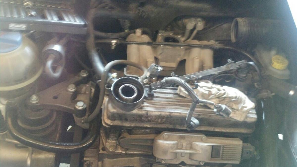

I'm coming with an update. Just had the engine cover unmounted this morning(my girlfriend was asleep and I woke up earlier). I couldn't notice any leaky from the intake. But, I removed the nozzle of the airfilter (part 18 from here) (thr one with a switch on it, to take the air from outsidr or inside the engine according to the temperature I guess) and I tried to obturate that hole, but the engine didn't die. Is this normal?
