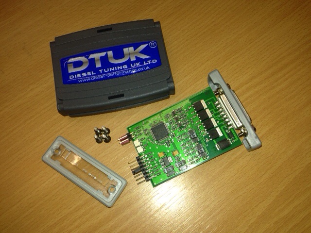

Any tuning box basically acts as a jumper. Regardless of what the retailer says, all it does is extends the injection pulse width and puts fuel in at the wrong point of the stroke which ultimately can lead to problems including bore wash. Some more modern units like Darells are a fraction more intelligent - but not much. You might make a fraction more power, but not in an efficient manner as per the Shark remap etc.
They are, and always will be a bodge method of tuning in my opinion. Psi boxes at £500 are among the worst I've seen. Cracked them open with tech inside that can be recreated with a 50p resistor. Insane.

DTUK's units are a bit more than a resistor in a box! And the new CRDt+ units are a step up again, plus they develop the mapping on rolling roads, they have even used Sharks RR to develop on.
Clearly some higher calibration than a psi box.  However let me ask you this.  How does the tuning box know NOT to add more fuel during a DPF regeneration.
Also, not being rude as you've helped me make my stage 1 decision but why go down the route of a remap over the DTUK plug in.  It's because they work in 100% perfect harmony with the diesel engines engine management system.   Tuning boxes will always be a "middle man" effecting the performance in a positive way but not always in a way that is beneficial for the health of the engine and exhaust system.
