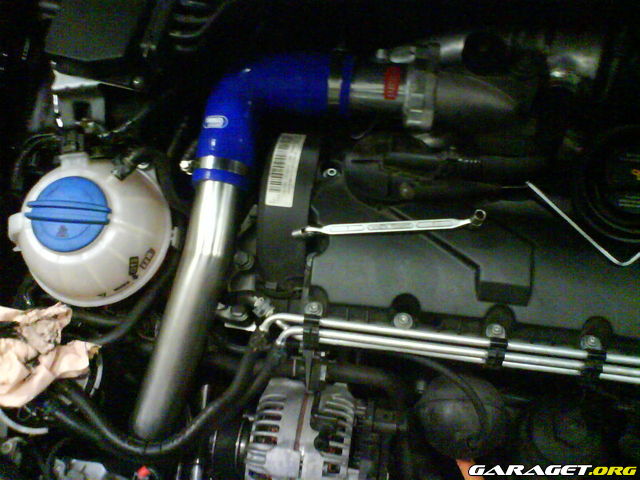

although obviously the second car also has the standard plastic pipe replaced with a "Dovit" metal one
I think Allard also do a metal one
I there there is also a Samco version available buit they are biiiiiiiig bucks
168164_486059295770_557325770_6549482_55
There was a guy on here years back cars vRS_Dovit or something similar who was making them (hence the "Dovit pipe")
became sought after when he moved on and stopped making them.
Allard still sell them

Pipe arrived today, that was next day delivery from Allard. Quality is excellent, will just be a case of seeing how it fits on the car.
Old v New
Fitted.
The thing to look out for with that pipe is that it doesn't have a beaded edge. I know some using them haven't had a problem, but there is a chance they can pop off
Quite right, all of the Airtec FMIC pipes are beaded so its nice and sturdy
