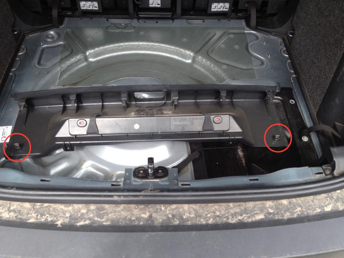

Basically, you need to pull the bottom corners of the boot lip trim towards the front of the vehicle to disengage the two clips circled red. Be gentle with them as the connecting blocks behind the trim is not very robust.

Just to clarify; the latch mechanism & switch is within the tailgate, so the trim on the tailgate itself needs to be removed to gain access....

Isn't the clip shown in post 35 above?
Ah - sorry I didn't see the picture first time.  However I can't really see what I am looking at or what clip is shaped like or what it fits into......probably obvious once you have trim off and can actually see the clip..(like it was on the Golf)
That picture in post 35 is of the trim at the rear of the boot floor, not the tailgate trim? I'm not sure removing that trim is going to reveal much that would help with a potential microswitch issue?
Edited by muddyjim
My bad for posting a picture of the wrong part. Sorry.
