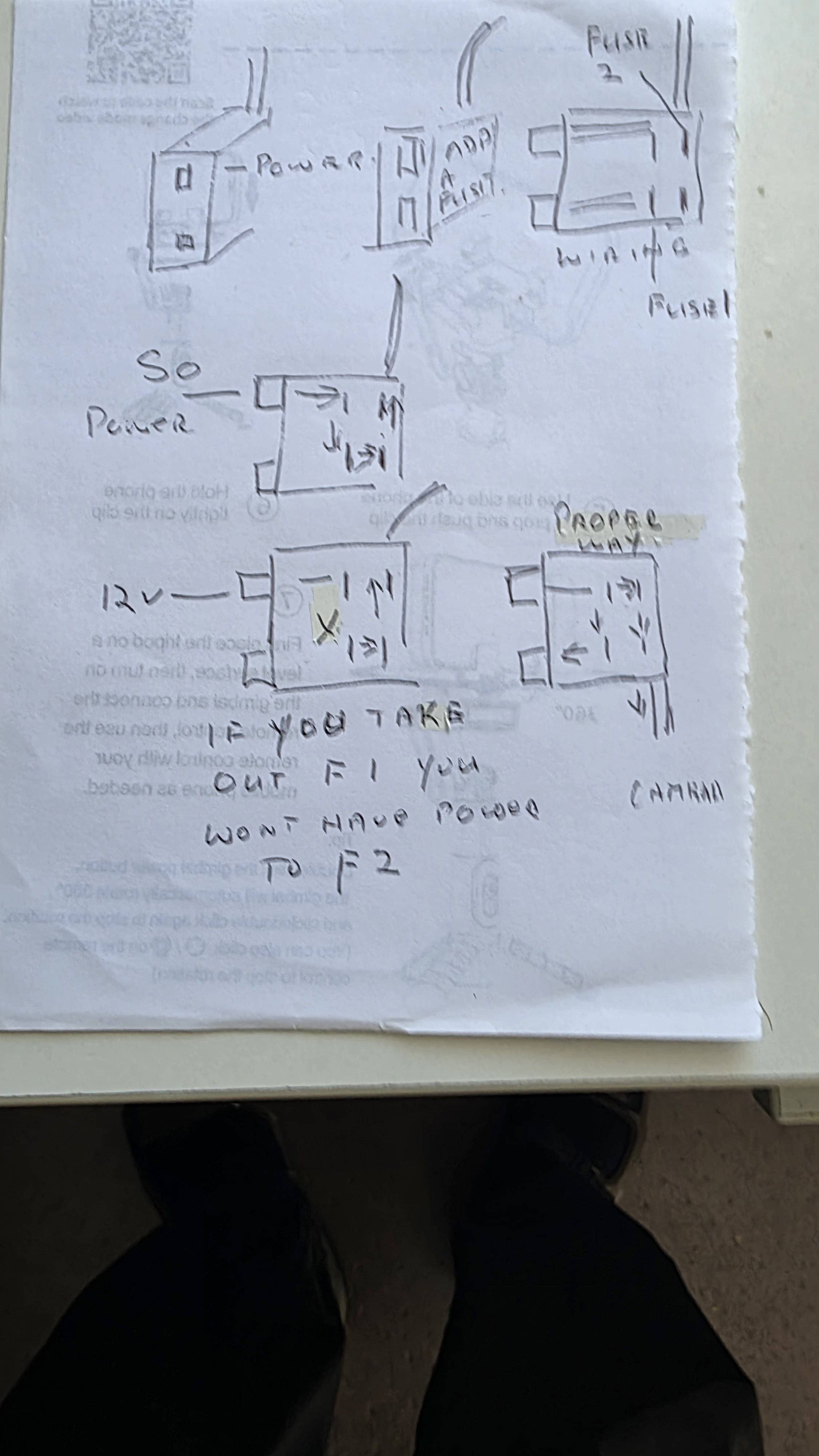

piggyback fuse "direction"
If you put it in with pigtail UP and power is at the top you are running the power through the original fuse to get to the second. TO prove what i say hook it up and then pull the original one Bet the camera goes off. Dont ask how i know. Also here is a link to installing a dual camera in a golf with instructions on how to remove pillar trim. Basically applies to all VAG models as it did on my Tiguan.. Make sure you feed the wire BEHIND the airbag or you could wear it in an accident and pull the camera off screen into your face https://www.autoinstruct.com.au/manufacturer/volkswagen/mk7-golf/mk7-golf-dash-cam-install/ https://www.autoinstruct.com.au/manufacturer/volkswagen/mk7-golf/mk7-golf-a-pillar-trim-removal/ To drop govebox just push sown on little tab and it will come down as per instructions https://www.autoinstruct.com.au/manufacturer/volkswagen/mk7-golf/mk7-golf-glovebox-headunit-removal/ Autoinstruct has quite a few good guides for different models Have a look through I f you run a addafuse to a empty slot and have it the wrong way you are running it back through the original fuse to get to the second fuse to the camera Proveable by removng F1 and camera will have no power
