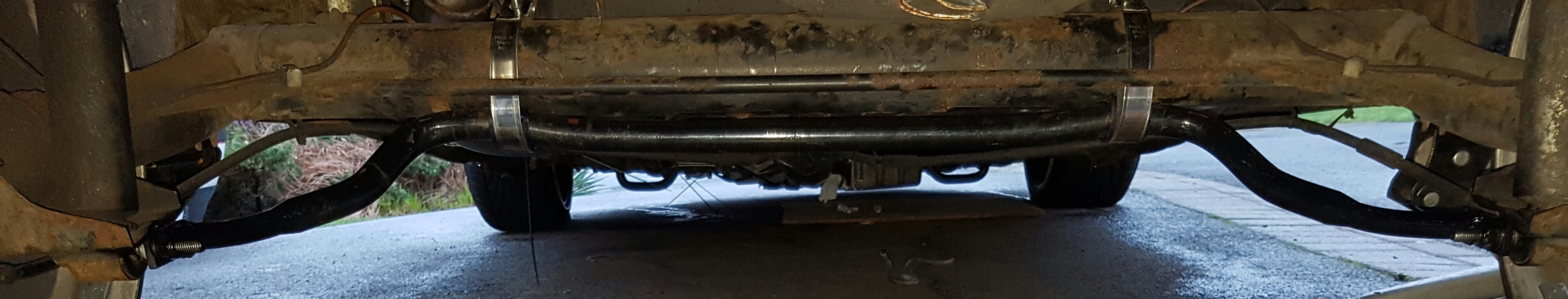

Thought instead of making a new thread i'd revive this old one.
Basically i have fitted a 27mm anti roll bar from a Mitsubishi l200 to the rear beam of my Felicia. I have done so in near enough exactly the same way as Tom originally did with the Tigra anti roll bar.
I used the Mitsubishi l200 ARB as it was the perfect shape, cheap and ideal thickness (my mk2 golf has a 28mm ARB fitted in the same way and it was the best thing i ever added to the car).
Photo is pretty poor sorry, had to crop most of it to get it below 4mb to upload!
Did any welding take place for this or is it "bolt up," to an extent?
Only bits that need welding are the tabs you make to go on the end of the anti roll bar with a 10mm hole in for the suspension bolt to go through.

@Jeggo don't know yet mate haven't drove the car since fitting it, been busy on the engine!
But i will say fitting a big ARB to the rear beam of my Mk2 Golf made the world of difference.
