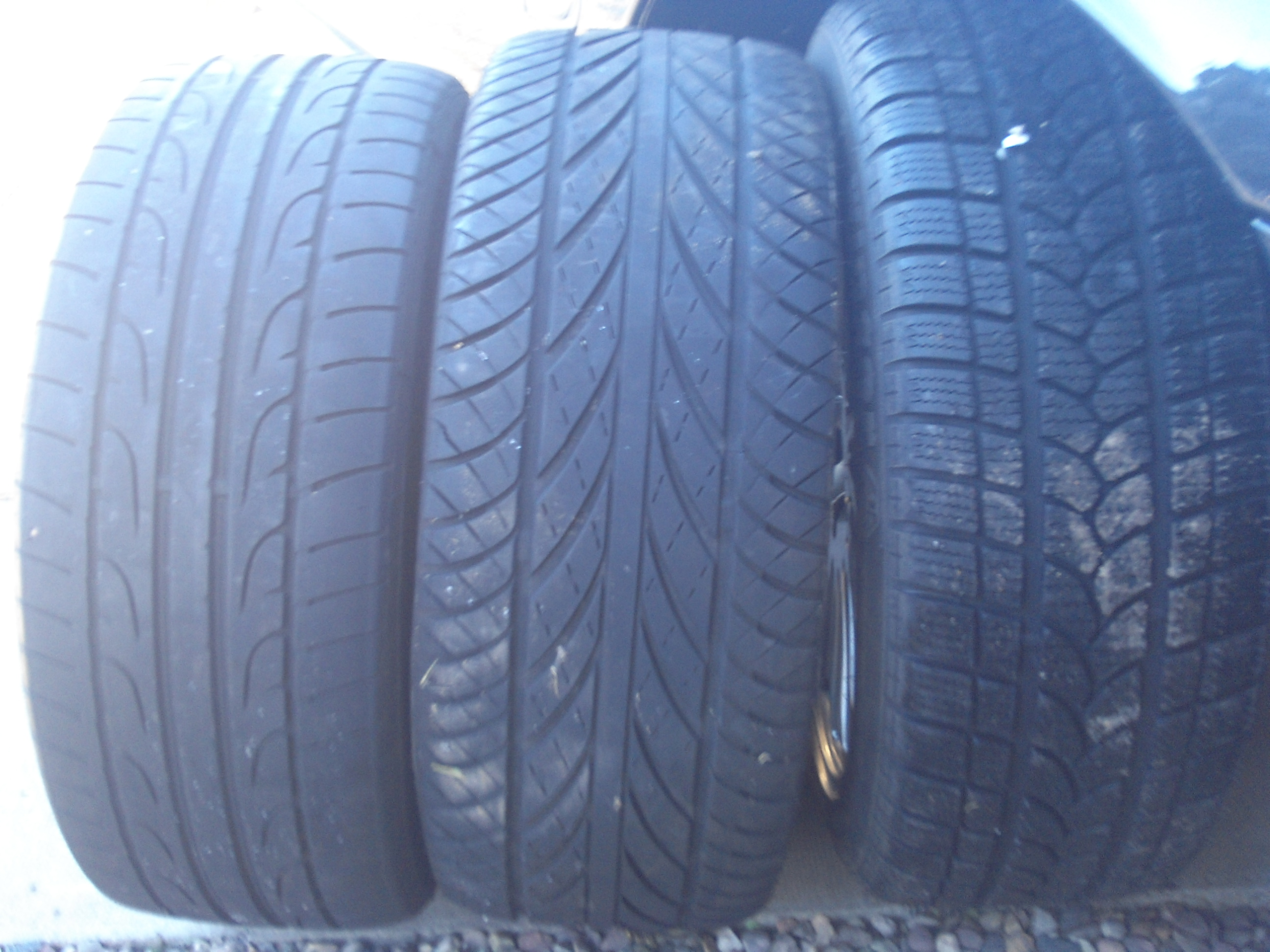

Websites, online calculators etc mean nothing like the numbers on the sidewalls often.
You need to physically measure different tyres side by side.
ie
a 205/40 R 17 can actually be taller when measured against a 215/40 R 17 from another manufacturer.

225/45 R17 too big, and 225/40 R 17 is smaller total circumference than 205/45 R 17 if you actually stand them side by side.

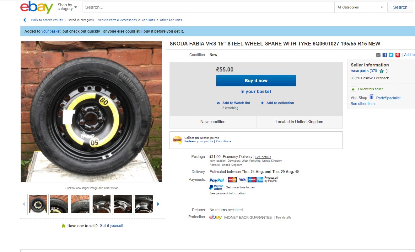

2. saw this on ebay http://www.ebay.co.uk/itm/132290723050  is this the correct spare wheel cos if it is i'll probably buy it!  will that work ok with the brakes assume also it has unidirectional tread and is speed limited to 50mph?

Yes you can go down to 16" with the Brake Disk size, you can go down to 15" seeing as the Factory Steel Spare Wheel that any UK Main Dealer employee should know comes as standard is 15" and fits at the front or rear axles.
You are as well to get a matching 17 or 16" spare and matching tyre as the wheels going on the car.
You would still need to drive easy if fitting and the tyre on it was brand new, but at least you can carry on with a journey.
A Full Size Wheel / Tyre fully inflated goes in the Spare Tyre Well OK.

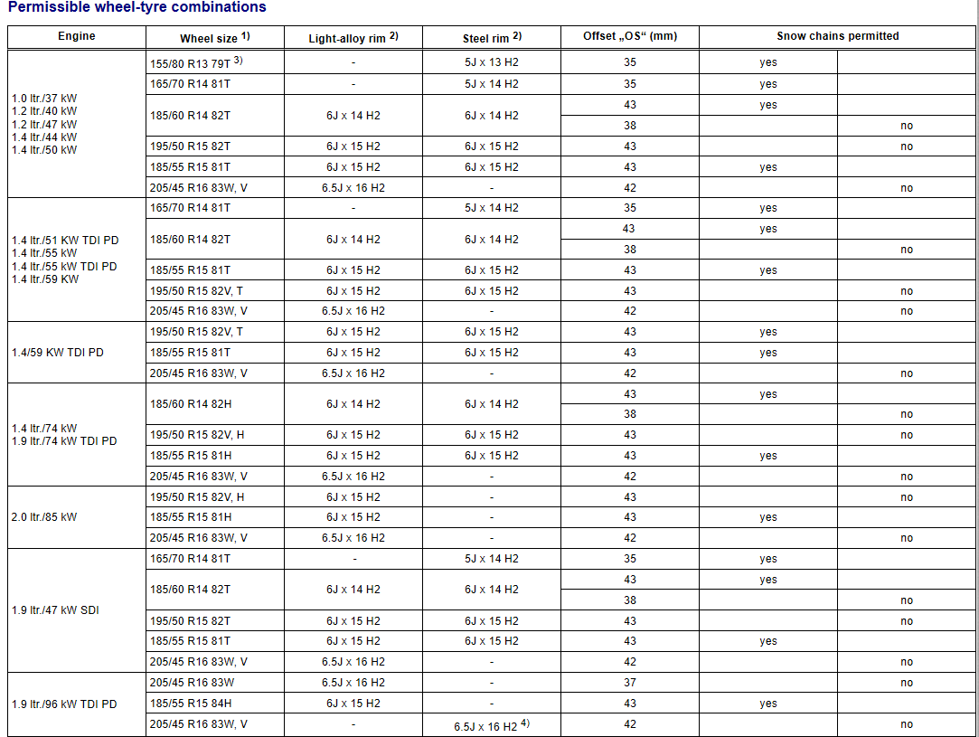

Just adding this table screenshotted off workshopmanuals.com as it includes all the info for MK1 Fabia, including load and speed ratings, and offsets.
The Mk1 forum seems to be full of queries about wheels and tyres just now, so thought it might be useful.
Edit: Note 1 refers to tyre inflation pressures and says look at fuel filler flap
Note 2 says 5-hole fixing, diameter of the bolt circle 100 mm, diameter of the central hole 57 mm
Note 3 says without power steering
Note 4 says it is only fitted as a spare wheel in series
Edited by Wino
