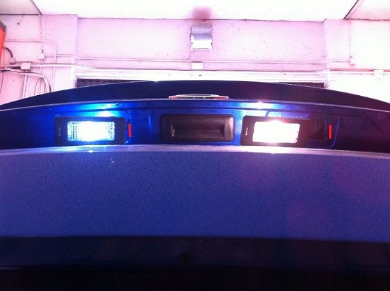

Here you can see the difference between Led (left) and halogen Philips Blue Vision (right):
012.jpg?t=1398542040
