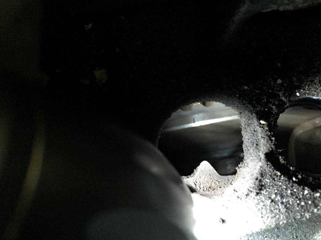

**update 05.08.2014** Changed bit relating to timing marks for crank.   **update 12.07.2014** Updated guide finished.   Foreword This is Squiddos new guide to changing a timing belt & water pump for a Skoda Fabia 1.9 SDI (ASY), I would imagine this guide would work for any vehicle fitted with the vw 1.9 SDI (ASY) engine. This particular car has AC fitted, there is a difference in the aux drive belt, how to slacken and remove on a non AC car, the PDF should show you that, everything el
