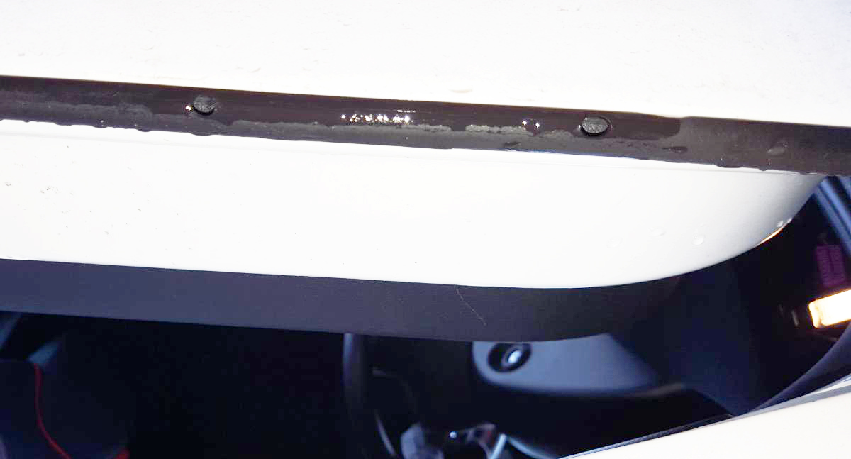

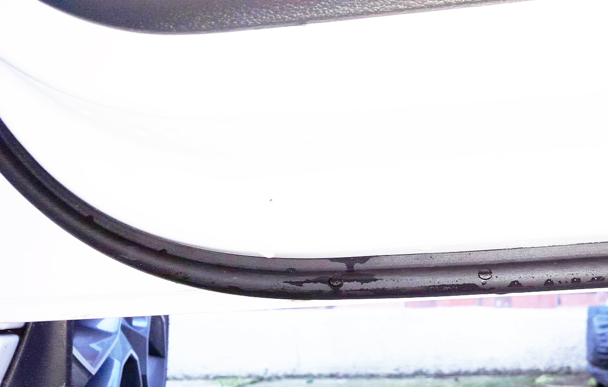

See x3 files attached
1 Outside of car showing the water run off
2 Outside of seal, note the holes are located near to the bottom of the seal (@ approx 5 O'Clock)
3 Inside of seal, note the holes are not as far apart when compared to the outside holes, also they are located at approx 9 O'Clock on the seal

Can you just mark the holes in your pics via Paint/photoshop as I can't see where are the outer holes exactly. As my 2 year warranty is over last year, I want to try to repair it my self as shown in your pics.
