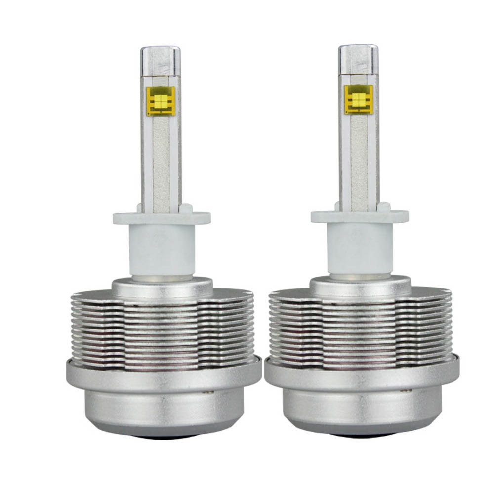

So I changed them for some LED’s http://www.aliexpress.com/snapshot/7338546343.html?orderId=72923300641797 now it is worth noting these do not dim on or off like halogens do, they are a straight on/off, despite this they are IMO brilliant!:
I have previously tried some CREE LED’s in our Yeti (again H8 fitment) but despite these being advertised as ‘pure white’ were too blue for my liking so they never made it into the S3 (if you like them then I still have them!)

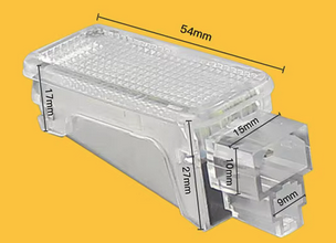

Boot lights
(no std photo)
Fitted with W5W LED’s from eBay (the flat 4x LED ones in the middle)
Now whilst these were a big improvement over std they were not as good as they could be, so I bit the bullet and bought the superskoda complete units:
http://www.superskoda.com/Skoda/SUPERB-II/Superb-III-MEGA-POWER-LED-cargo-trunk-light-KI-R
These are MUCH better!

Hi.
Contemplating replacing the internal door lights with some of these from Superskoda, http://www.superskoda.com/Skoda/SUPERB-III/Superb-III-MEGA-POWER-LED-door-safety-lights-WHITE-WHITE-KI-R
I haven't collected my new Superb yet, delivery set for Saturday 9th April. Can anyone tell me if these fit both the front and rear doors ? I've asked the same question of Super Skoda but haven't received a reply yet...

Have fitted fromt and rear sets both the same fitting just order two pairs they are all white without the red section 5 minute pop out job and very very bright

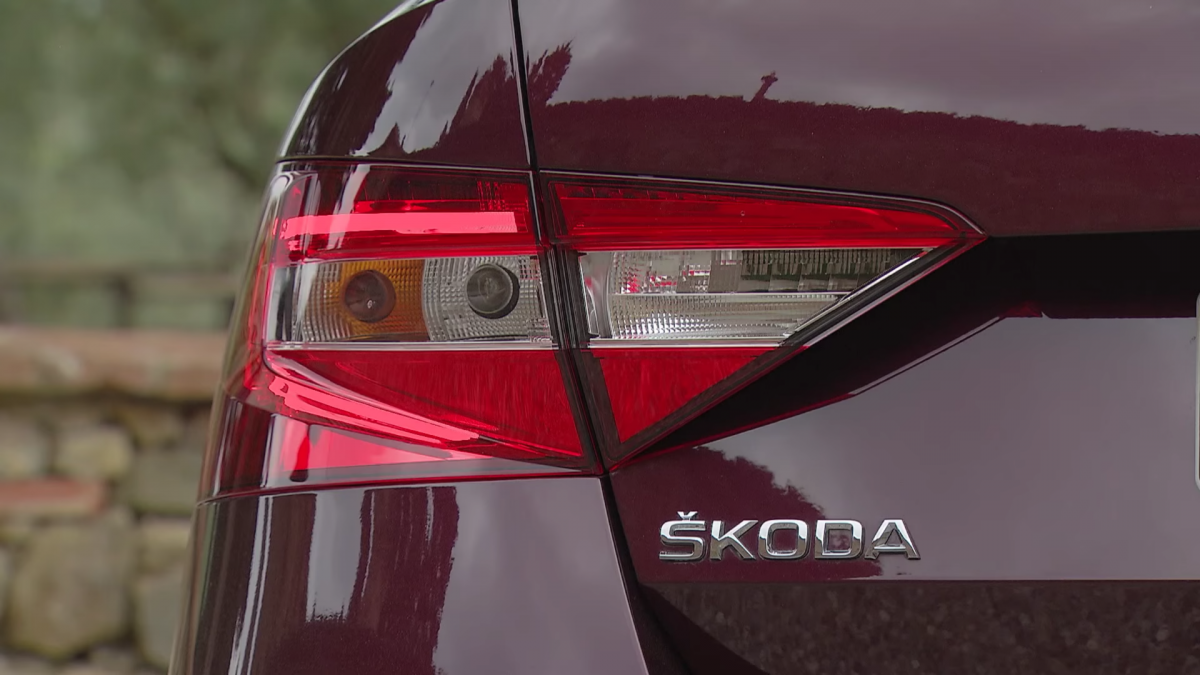

I just spotted this... Check out 1:10 on this video:https://youtu.be/s5MD4mNQzFs
Maybe certain countries don't get the silver caps on reversing and rear indicator lights?
Here's a screenshot.
