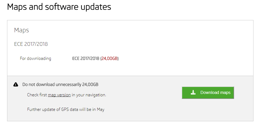

I've just checked and I'm still showing: -

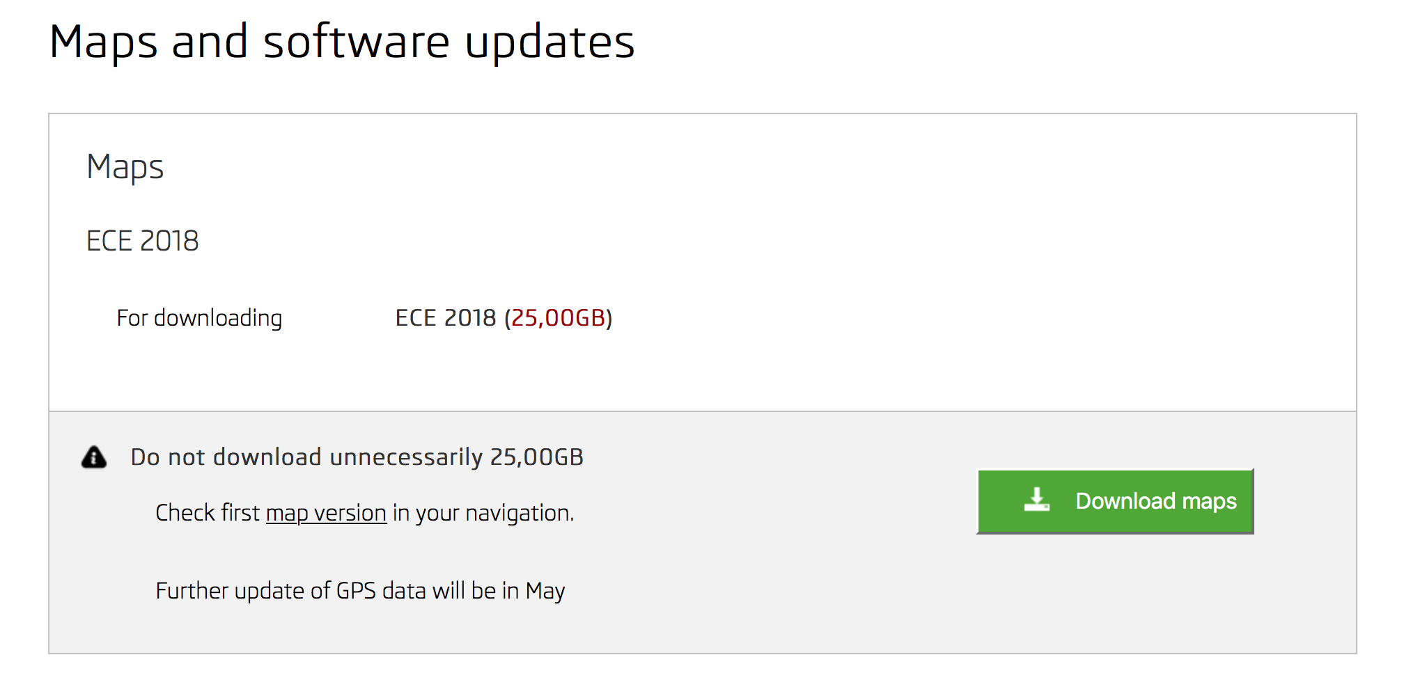

Hi,
I've just logged on and 2018 maps showing on the Skoda update portal for me. :wondering:
The file I downloaded (to a Mac) is zipped and I unzipped it with Unarchiver. It would not update straight from the file for me and I had to unzip and copy the files mentioned in my last post  to my SD card
@Sagalout says you don't need to unzip when downloaded from Windows
5a0cd44d25246_ScreenShot2017-11-15at23_55_24.png.a6a4069cf16c32633ca1efc2bbad7d67.png
I would copy straight to your newly formatted SD card and see if it works.

The file you quoted in your post is the same as the one I have down loaded so thats a good start, I've even tried a different browser and its still not showing ECE2018 for me, mine is a MY16!
I hate this bloody system as I don't want to take a chance and screw the bloody thing up, maybe I'll wait until I'm offered ECE2018 for my VIN.

Yep, just tried again and the offering is still the same, it must be driven by the VIN, what model year is yours?
Model year MY17 (last of the models before  MY18 hit the showrooms.)
Because I'm a curious type I started the download for the 2018 maps off the portal. The update is to P166 maps, same as the file you have downloaded.
I would work with that and forget about the portal.

Try clearing your browser cache. It may be reloading a previously cached copy of the page. My MY16 VIN is showing the ECE2018 file.

Even using the laptop its still showing ECE 2017/2018, I'm giving up for now
