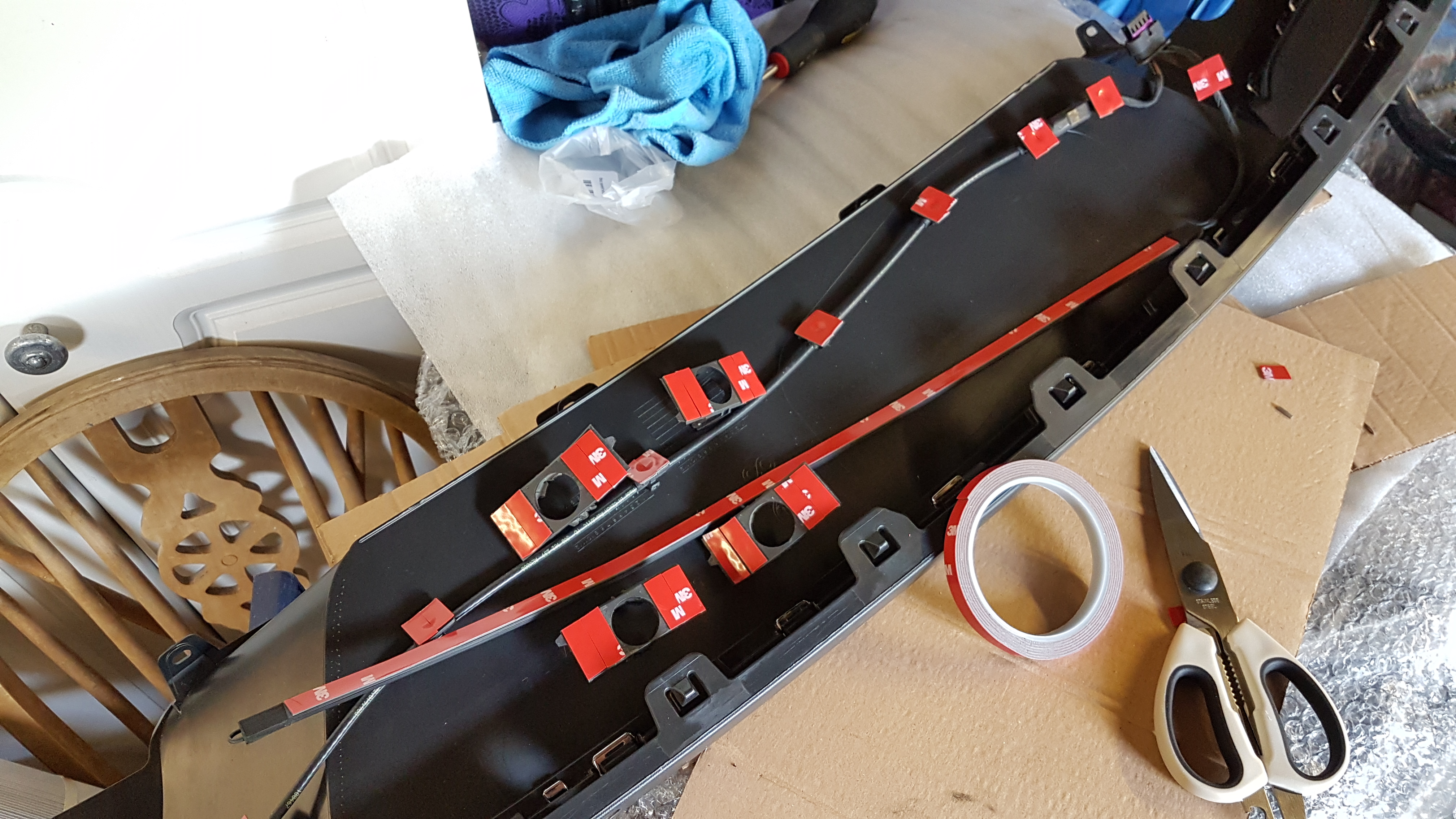

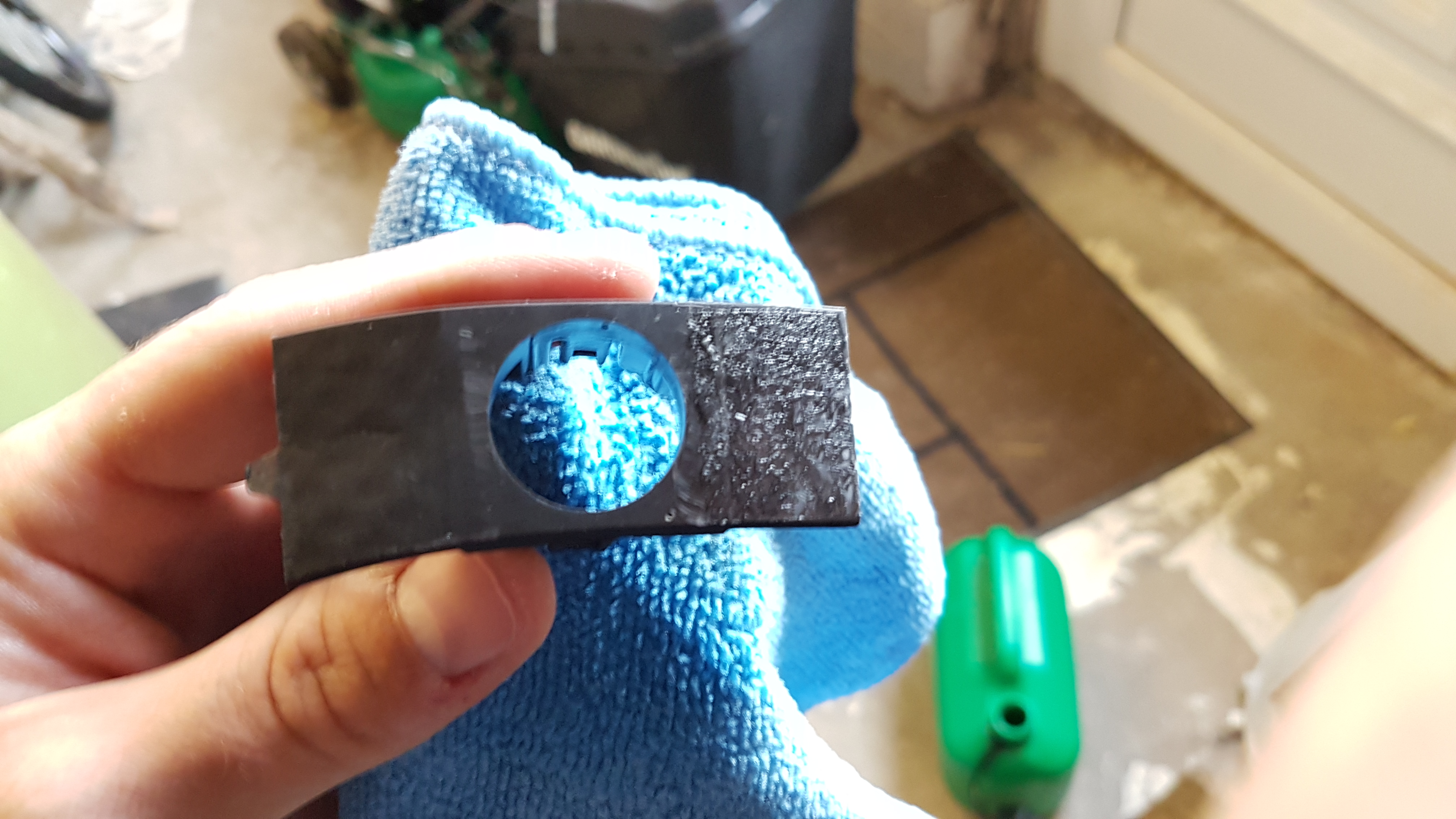

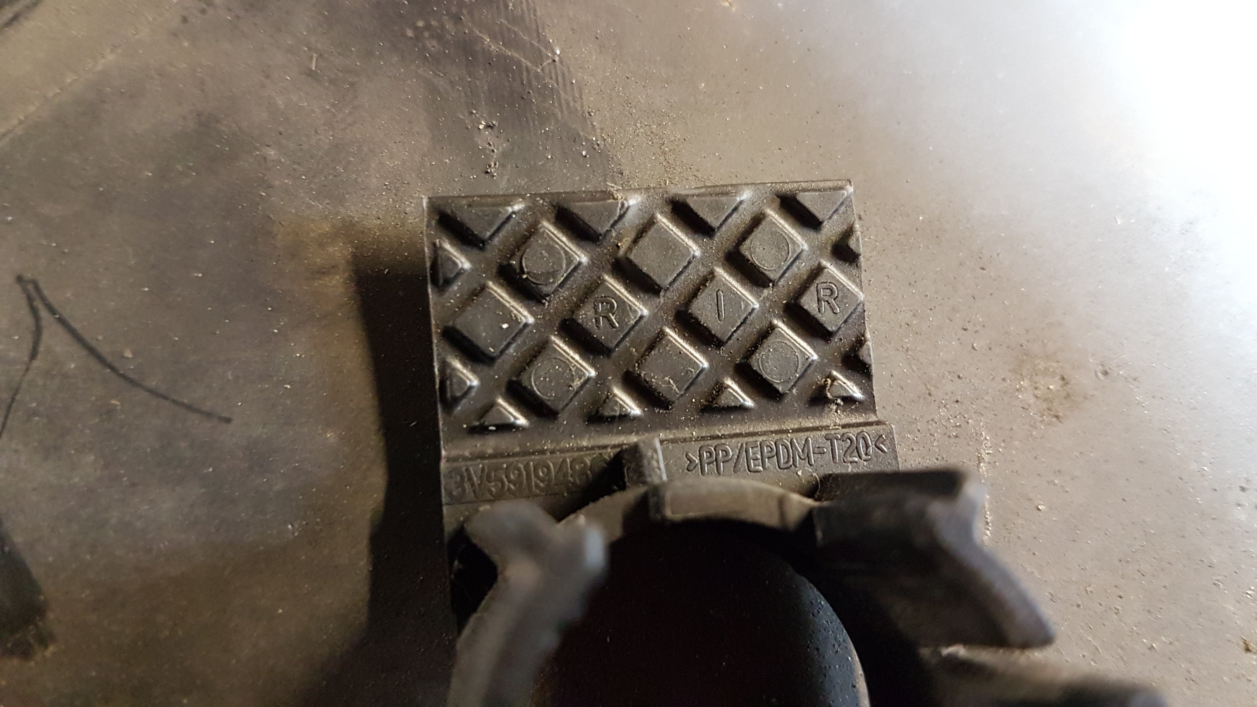

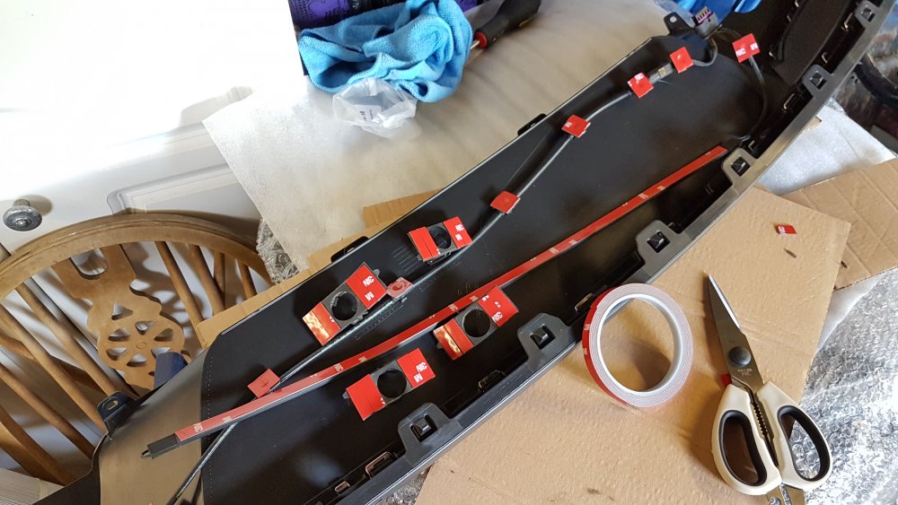

I didn't use any glue for the sensors just 3M tape, as they felt rock solid once fitted. I used warm water and a knife to get the old 3M off, then used petrol to clean all the glue off and get them like new again.
The pics show how well the petrol worked getting the glue off (left side after petrol, right side before), where the holders are marked up (example is RIR for 'rear inner right'), all the bits 3M'd up ready to stick, and after photos :)

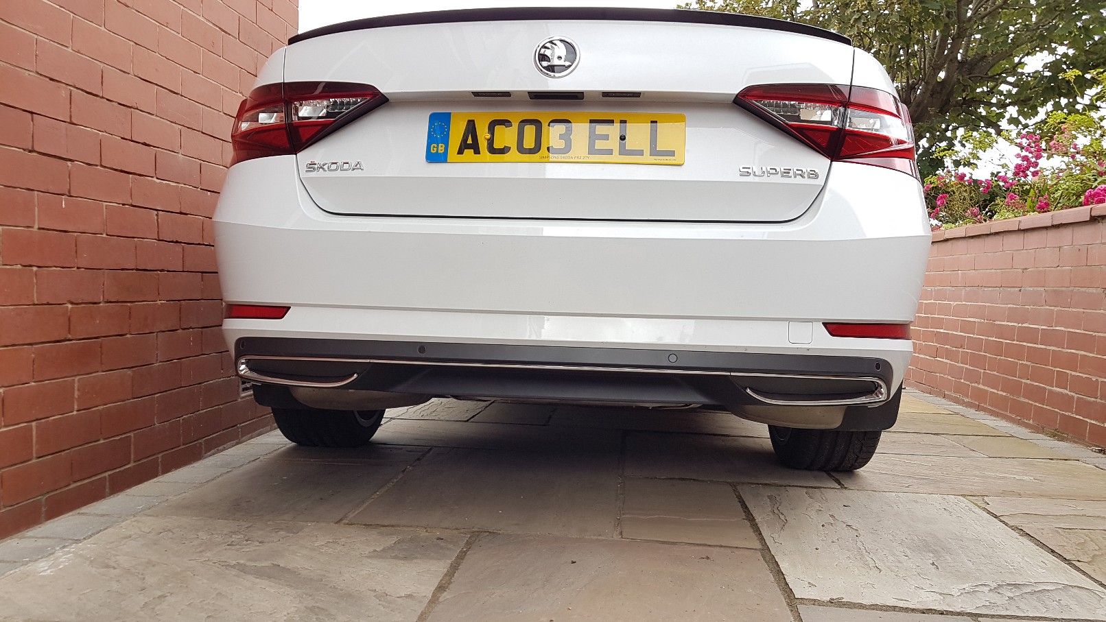

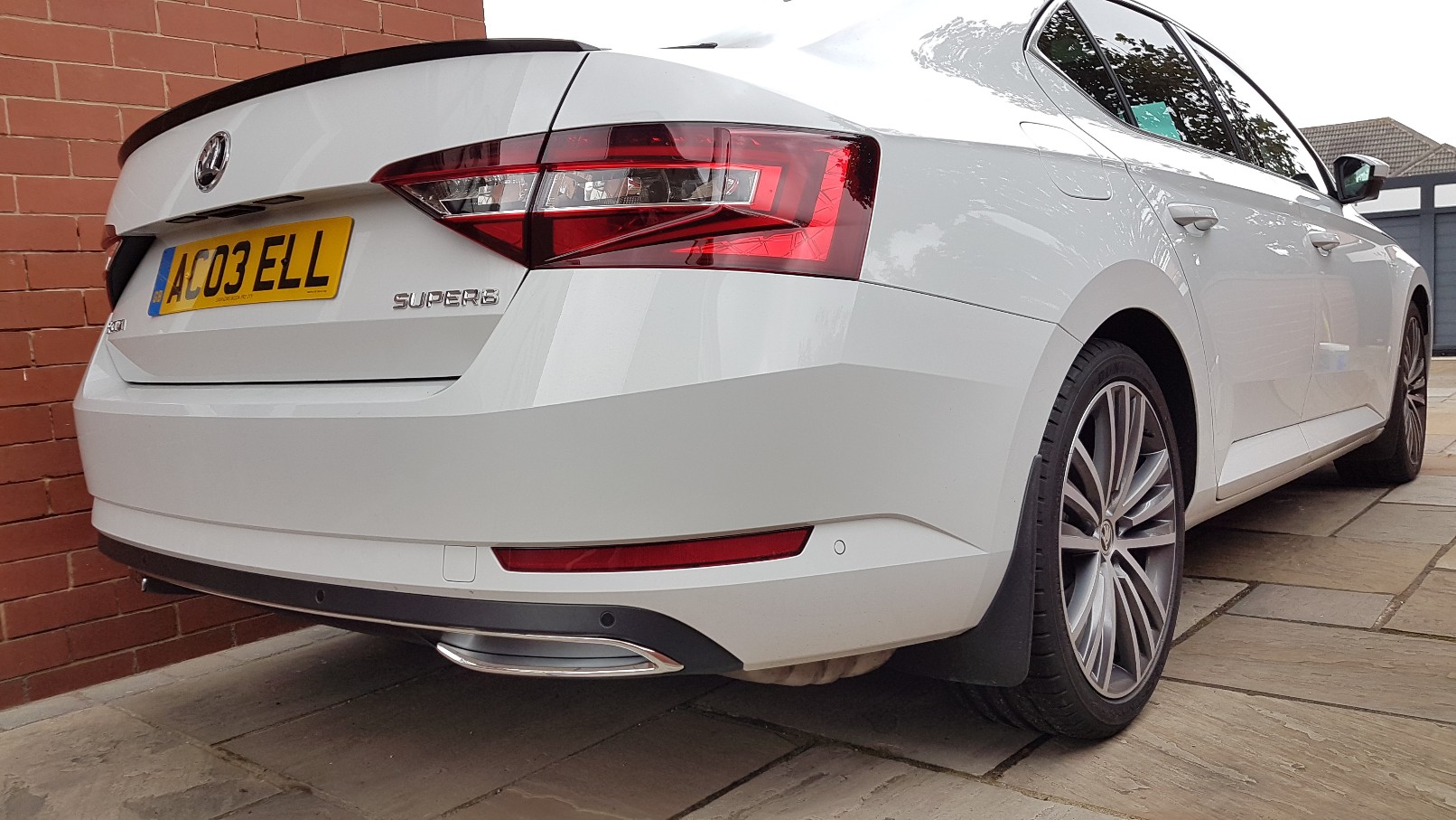

Finally got and installed the Sportline Rear Diffusor on mine!!
Pleased with the final result.
not pleased with the pain in zee a55 effort required to get the job done!!

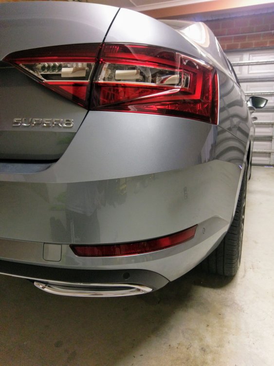

2 hours ago, Gizmo said:
Let’s hope the chromed plastic hold up better than mine - which is pitting already :angry:
bugger, not wat i was hoping to read!!
fingers crossed the chrome holds up on mine.
