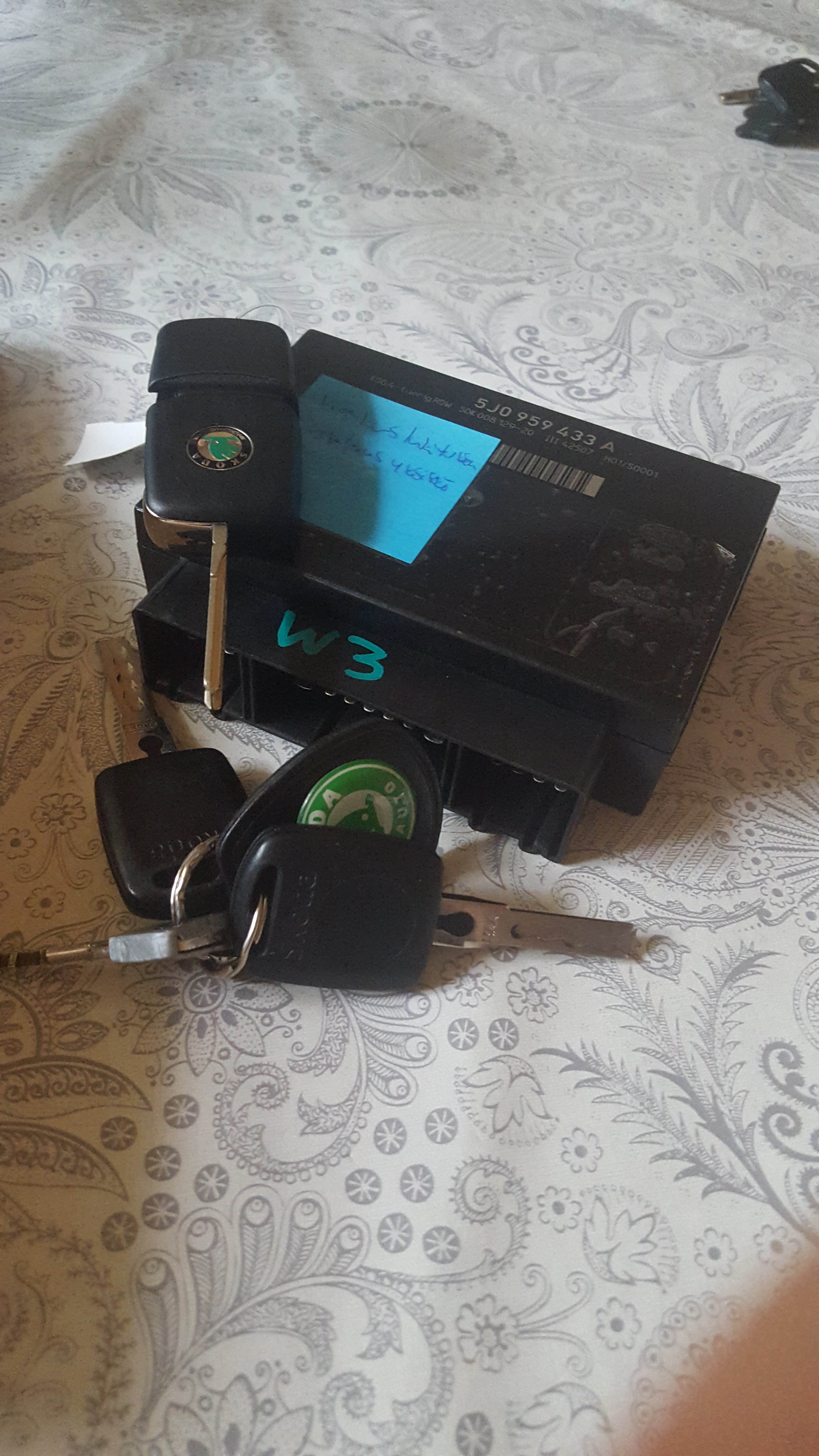

Yes i did know that. I asked that kind of kit from skoda dealer and I think it was bka 700003. But I wanted to do OEM fitting. And all the people who has done this kind of improvement have told that it's possible. Only coding seemed to be problem but then we decided with father and friend of mine that we take coding from dealer. My friend would have been coded it with me but we don't certainly know what to do.
Now I've got everything that I need for remote control upgrade! Only coding is needed for this case. A friend of mine has vcds but we don't maybe dare to do it ourselves so I have to book a time to skoda service:blush
Hi!
Sorry for not updating here for a while. But all the things went fine. It totally worked. I've got now remote control on my central locking. It works fine and it's oem fitting. Big thanks to all of you who were helping me. One thing keeps me little irritated.. I didn't have to make anything for coding and I didn't learn anything about vcds things. :dry: Also the roof have changed colour. Before it used to be white but it had a little lack fault so we decided straight to paint it black :biggrin: now the colour is a little bit more solid than before
