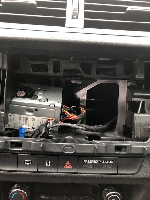

Hi all, thought I'd post this nice an simple walk through as there isn't a lot on the web and a few have asked questions on the Fabia mk3 stereo.   The display part of the head unit come out with insertion and pushing outwards of the four release keys.   As mentioned elsewhere, this is just a shallow depth screen and the main gubbins is in a single DIN package shown behind and to the left of the display.     It is got at by removing the glovebox and remov
