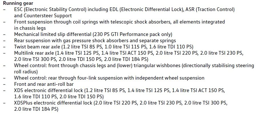

On a recent trip to Snowdonia, on surprisingly pleasantly quiet roads I was able to give the car a bit of exercising (within the bounds of wife tolerance)    Whilst the steering feel isn't the best (no feedback) and  handling is OK when pressing on, I did notice that the back end rolls a bit disconcertingly even with gentle acceleration on a fast sweeper - despite the hard rear- and the car doesn't feel sure-footed. The 1.4TSI 150 warrants a better chassis.    (I do now have
