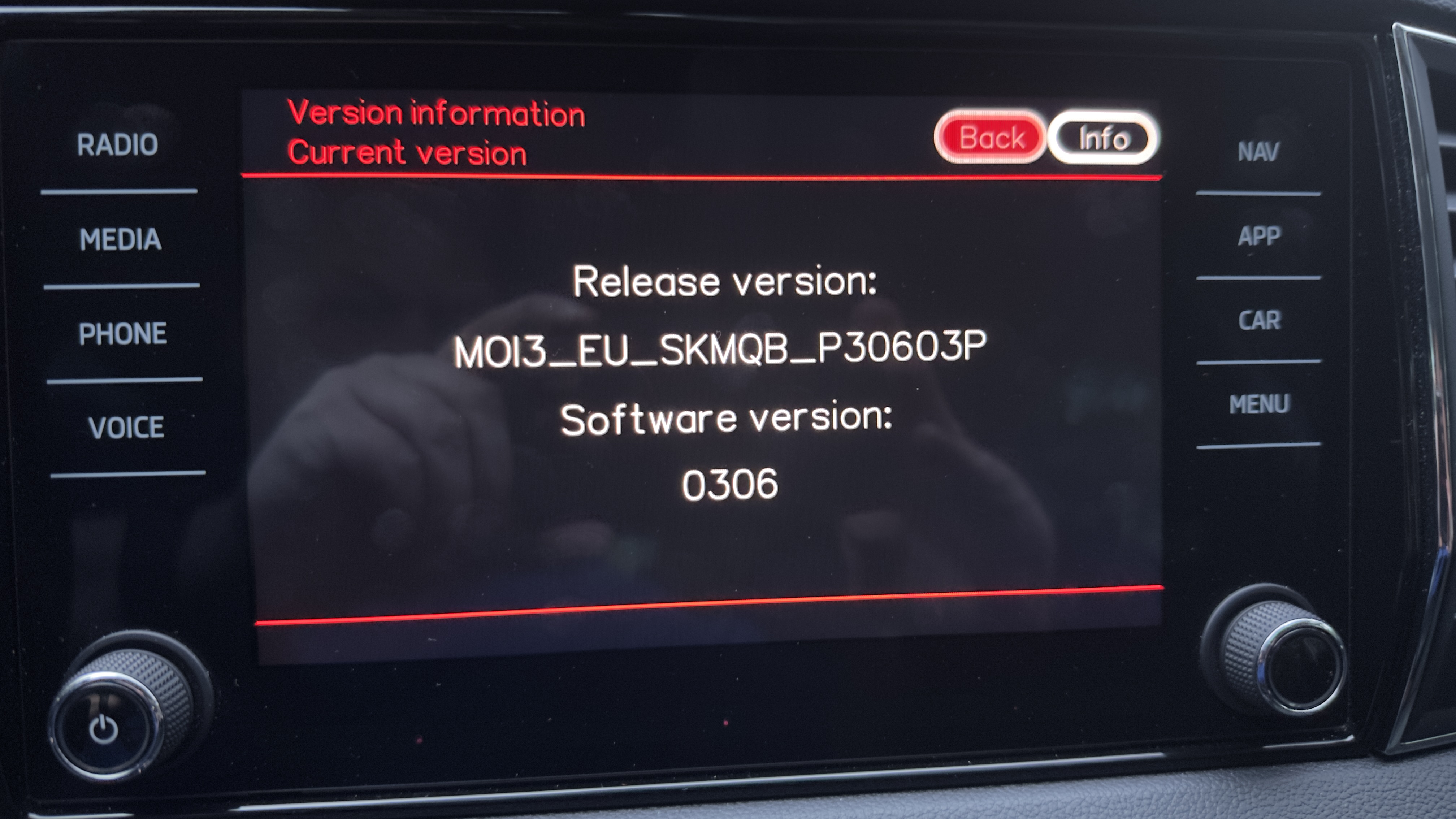

Has there been new updates rolled out since 306? I have a Skoda Karoq with virtual cockpit and Bolero unit with software 306 installed. I don't have navigation but I'm experiencing some small bugs that are becoming annoying like: when setting a destination on google maps I get a message "Compass unavailable" in the VC and I have to exit the navigation using the steering wheel commands and the get back and then I can see turn by turn navigation, some times the 3rd option for configurable dials layout in VC is missing and it only shows 2 options instead of 3, other times when put the car in reverse it shows only the back-up camera without any guidelines or overlay, it doesn't always enter in Android Auto but this could be phone related, and other small issues regarding VC and Bolero.
I need to verify when near PC, but 320 was released 15th November 2022.
If rolled out OTA, might be a while as they probably release in batches.
EDIT: Glad I checked, the 320 release can only be applied if you have 308 installed as seen below in SupportedTrains
"Release": "MOI3_EU_SKMQB_P32000P",
"MuVersion": "0320",
"SupportedTrains": ["*_?308*", "*_?310*", "*_?312*", "*_?314*", "*_?316*", "*_?318*", "*_?320*"]

Any way I can get a download link and how to update tutorial? I’ve included a photo of what the service menu shows, but there are no OTA updates available, maybe because I’m based in Romania. I can ask the dealer to update it for me and claim there is a warranty issue like the bugs I’ve detailed.
/cdn-cgi/mirage/7f3a4109b7c9db5275ba0696e58b3cb7d9ae65c743ad6ace706caf7e66e199cc/1280/https://www.briskoda.net/forums/uploads/monthly_2022_12/BEEDD484-D7C6-4252-BE7B-BA9223AC3500.thumb.jpeg.85cfaf5083196a8233284babb38b7d5b.jpeg
The 320 version will only apply if existing is 308, see above post under SupportedTrains.
So there is no way to perform update, it's blocked.
Ah, OK, I thought that I could update to 308 and then to 320. But I guess that supported trains means a combination of head unit hardware and car. So there is no upgrade path from 306. Thanks

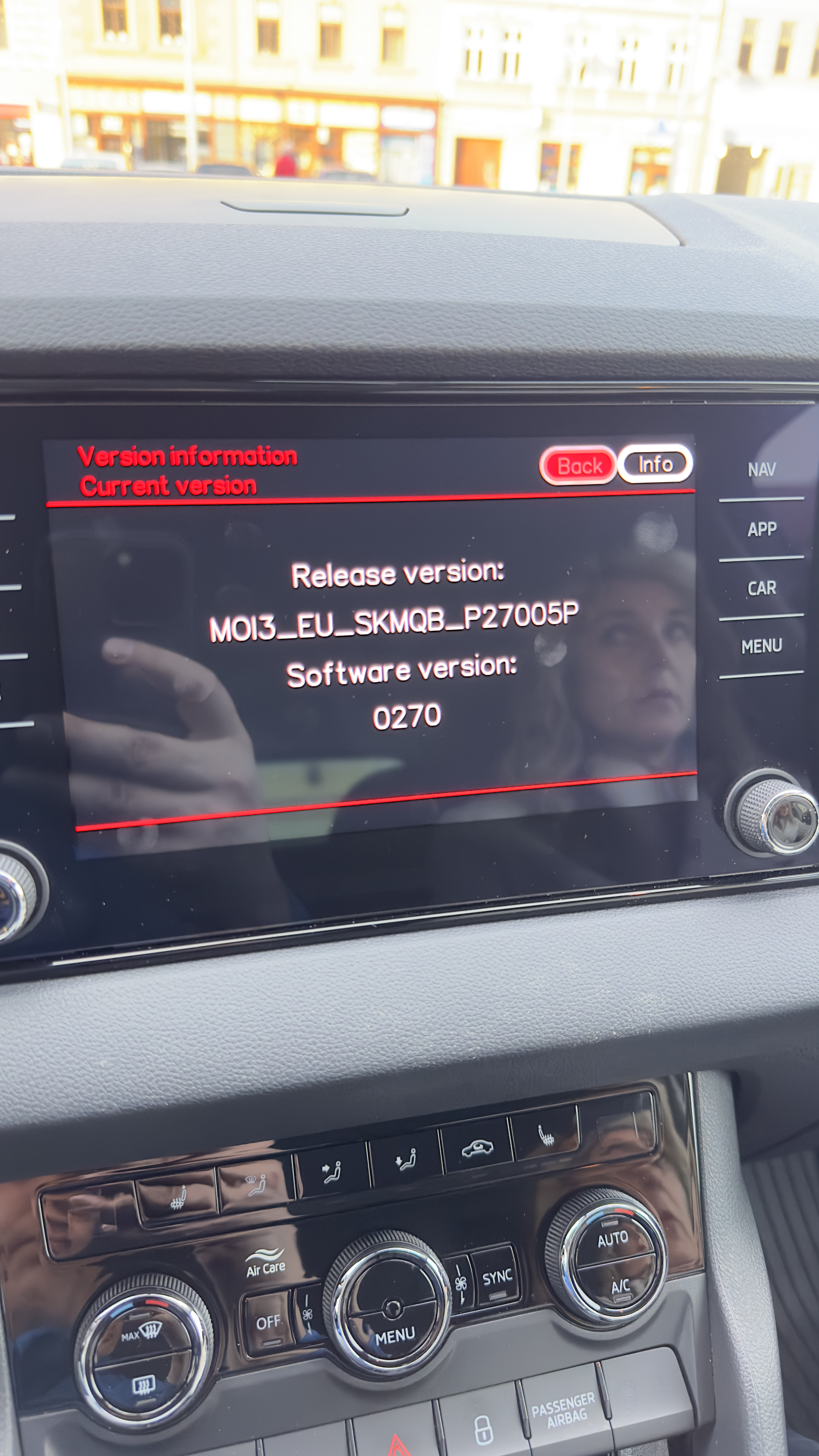

Dne 26. 2. 2023 v 12:14 Sofer0 řekl:
Hi everybody
Is the same update for a Skoda Kamiq Montecarlo software version 270?
10 minutes ago, Gennaro81 said:
Hi everybody
The key value you are looking for is the release version (what I call Software Train) to be MOI3_EU_SKMQB_P27005P in your radio, and you can update to 0306 version

Just now, Gennaro81 said:
Where can I find it?
I will send this to you via private message, please make sure to watch the youtube video above while you download

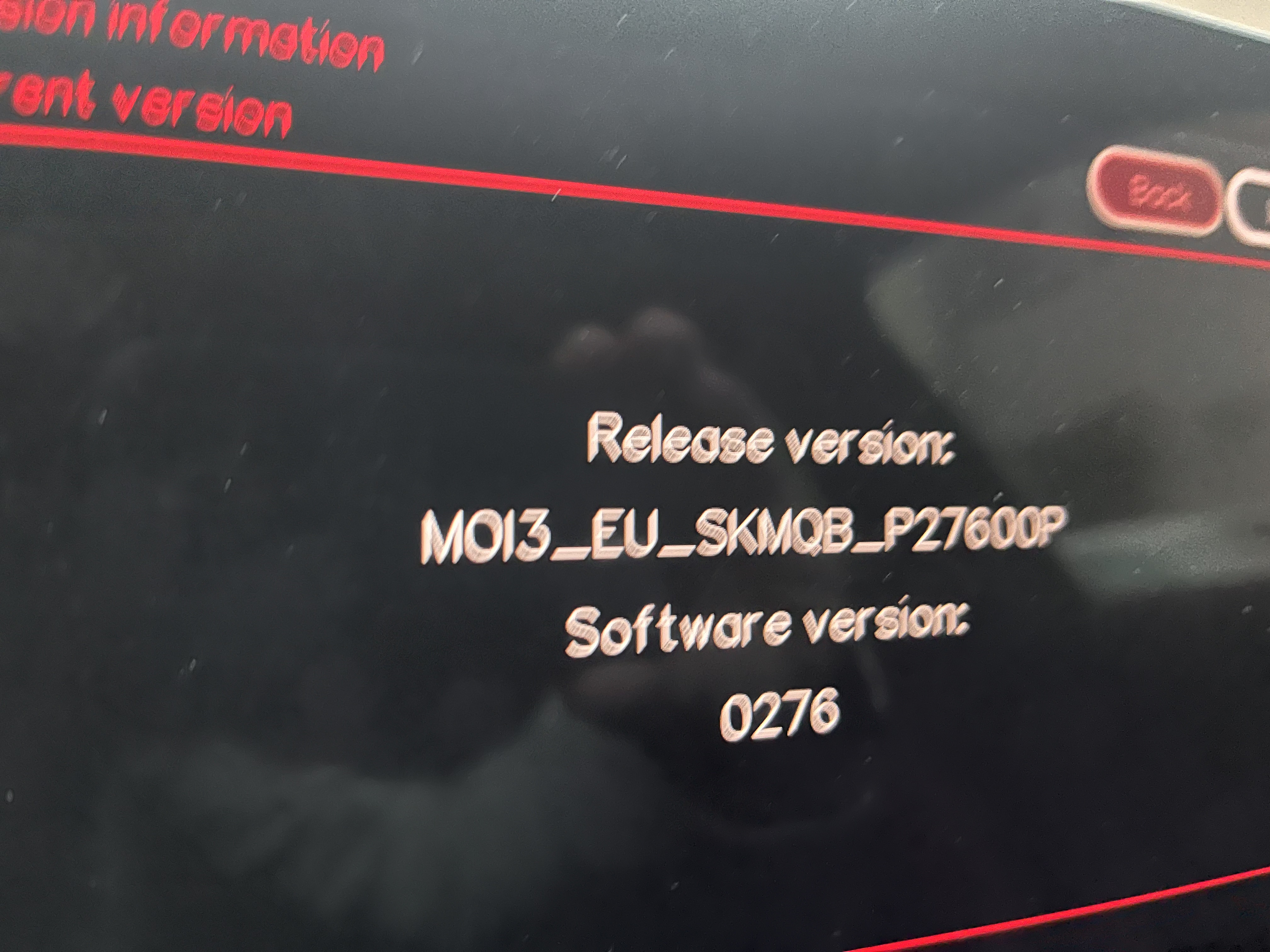

I'll correct myself... it's version 0276! Can I update the same?
Yes you can update to 0306

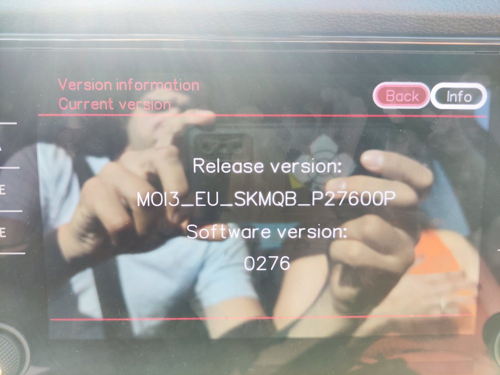

Hi!
Just registered here because of this interesting thread about a possible software update for my Karoq!
I wonder, if it would be possible to update my Karoq's software, MY 21, too? Which is the currently available software version? 306?
Hardware level is H22 and software is currently 0276.
Could not really follow the vid above 'cause it's in Italian language 😁 The steps necessary to update using an USB stick are clear, though.
Anyway, would it be recommended to update myself?

Welcome to the forum Michael,
Yes the update should bring you to 0306 should you wish (if your Software Train is in the correct format)
I cannot understand Italian, but seeing the screens is much more helpful than me typing out 20 steps for sure.
