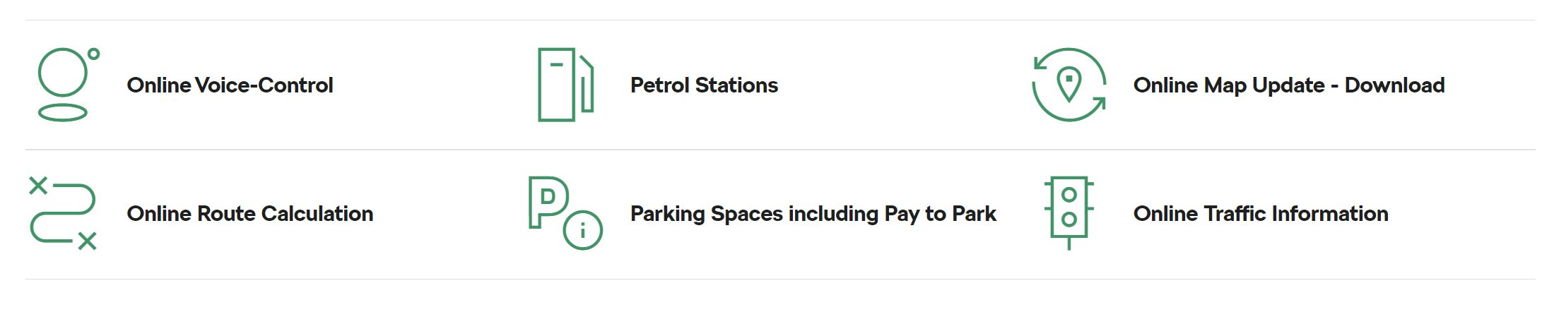

1 hour ago, Tell said:
I did wonder how much you were unravveling from connect services.
to activate data plan for builtin Wi-Fi Hotspot are required extra purchases,
which i didn't mentioned cause i ignored
€35    25Gb    365d
€18     5Gb      90d
€7       2Gb      30d
i selected just this one
€40   1y   Care Connect - Remote Access, useful for me
Skoda-Connect_Care_Connect_-_Remote_Access.thumb.png.5ec5b95b32d36ac28fdcdd2533c55a92.png
€50   1y   Infotainment Online, i ignored
free       Infotainment Apps, not tested
Thinks that's all I'd do if I had an EV and wanted remote a/c heating whilst on charge before leaving.
