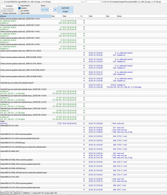

Any experts on editting these files. Needs SE in place of SK for Seat in these MULTI.MNF file and MAIN.MNF
I'm think if a Skoda user changed the VW part to SE and it still worked in a Skoda it will pass the test. Seat people with mib3 haven't had any success yet.
Also this French link
https://forum-auto.caradisiac.com/topic/566543-leon-4-maj-données-radio-et-logos-des-stations/
They were confused about it identifying a file that isn't in the download. I reckon that might be looking at where the file arrives in the unit to do the signature check hence why you don't see that file name ?.
Any takers for the challenge of what is going on and whether if you edit a working file that a Skoda reads replacing the VW to SE in those files it would work on a Skoda on the import. That would test whether there is a signature check on the files being changed. Reckon that could be the element that the French Seat people were umming and arring about. There is a signature in that file but unclear what that file is.
It could be that Seat mib3 people having perfected the art yet of reading off a USB-C into the unit.

Feel free to try editing the VW out of the Mib3 parameter files and switch to SE, just to see whether a simple edit messes up the integrity of the files.
test failed -
Škoda's Amundsen didn't recognise update with changed '-EU-VW-' to '-EU-SE-' in the multi.mnf and main.mnf
6 minutes ago, MartiniB said:
test failed -
Thanks. Yes that signature file must link into what it puts into the unit rather than what it's going to do or something like that. Why it has a file name in it, that's not in the import. Seeing signature files is generally bad news meaning it's locked. They must have done a good job of that.
Question now is whether mib3 files will be carried over into mib4 like maps, radio logos, if not the life expectancy of those to be updated is in question. Maps are probably 5 years or so last conversation but radio logos could be like the mib2 user POI import much shorter. Now you see it, now you don't as they sign off on it and pull the ability from their websites.
