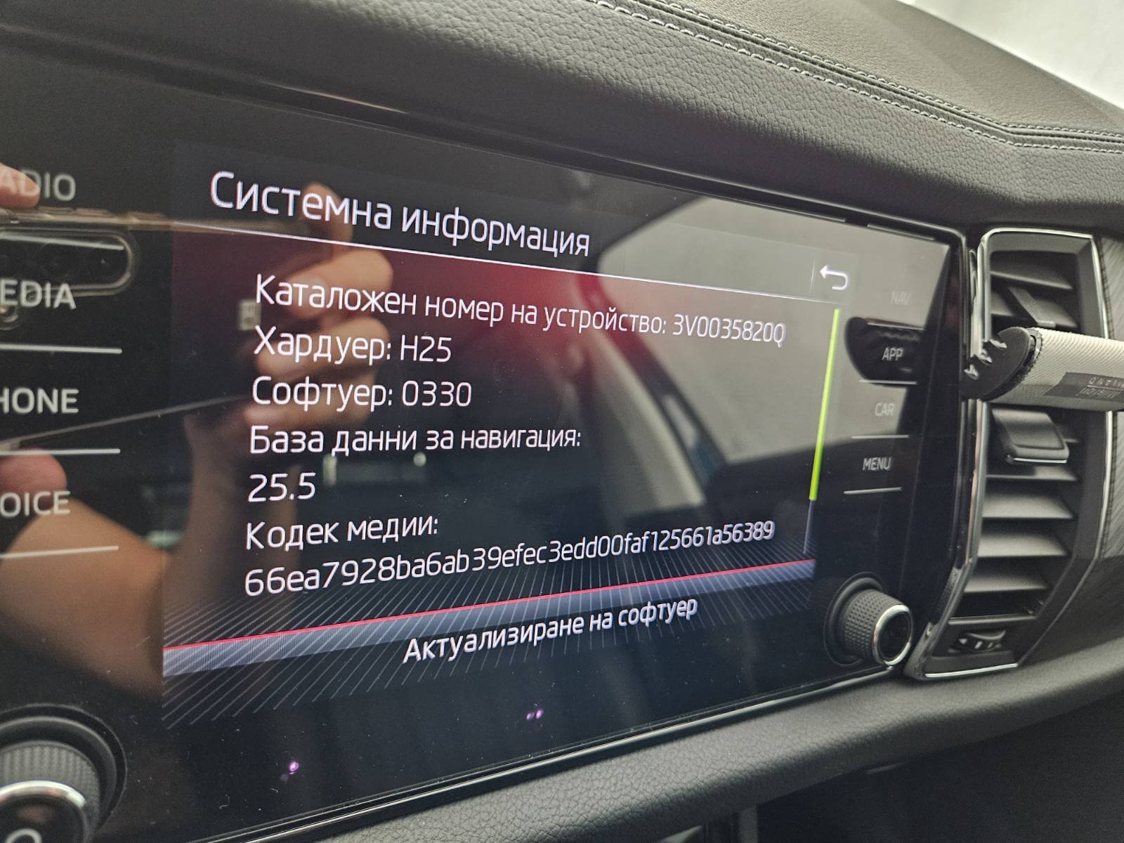

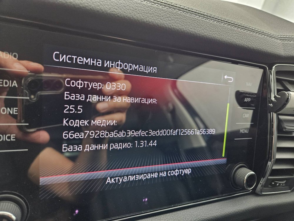

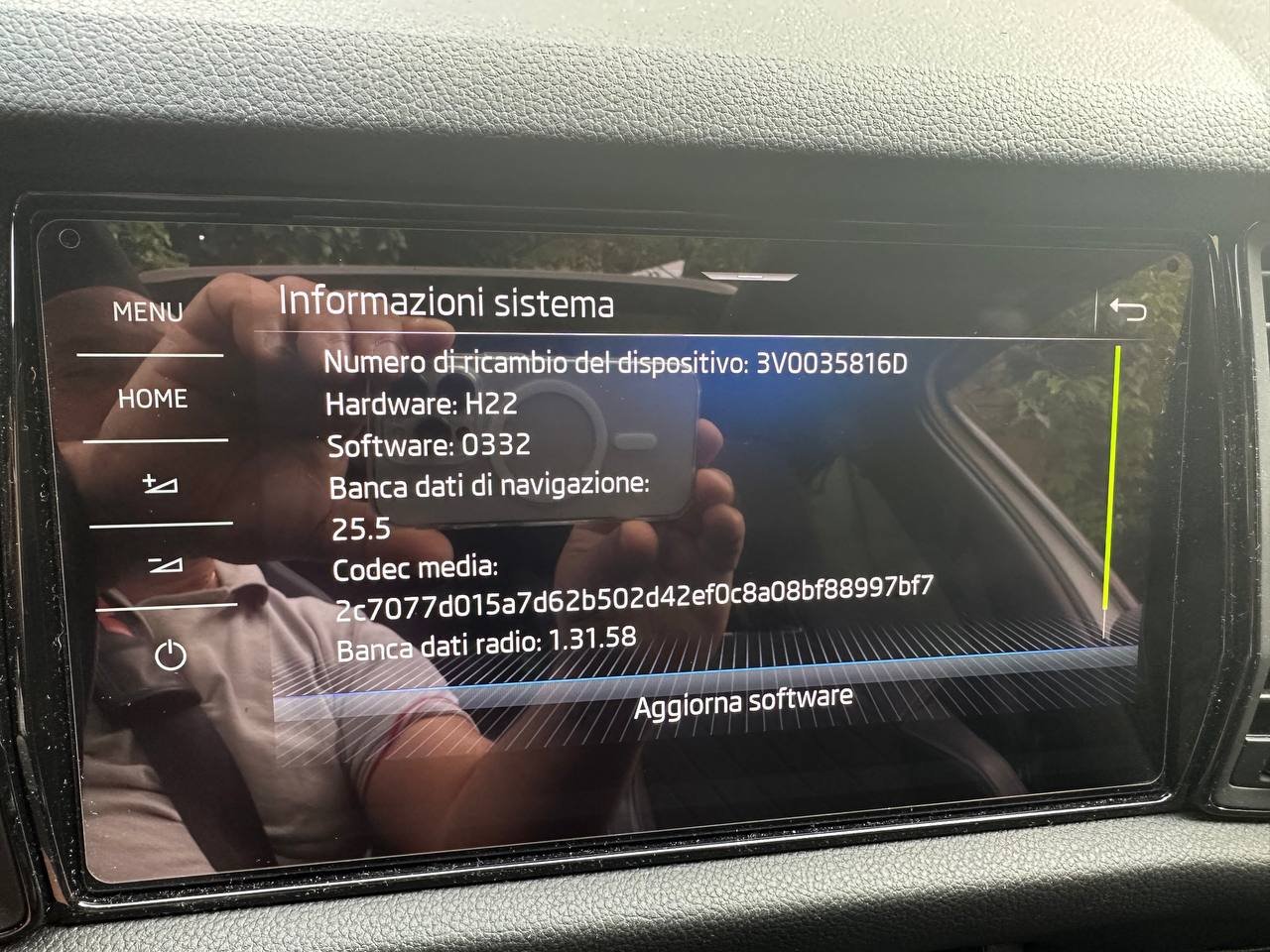

I received the update over the air. I pay an annual subscription.
Map Updates 2025.05
2025.06.17 +Chile, Turkey, Gulf Region
Map Updates 2025.05
I forgot to write that the maps are for Europe.
Also for me! Finally! 😎

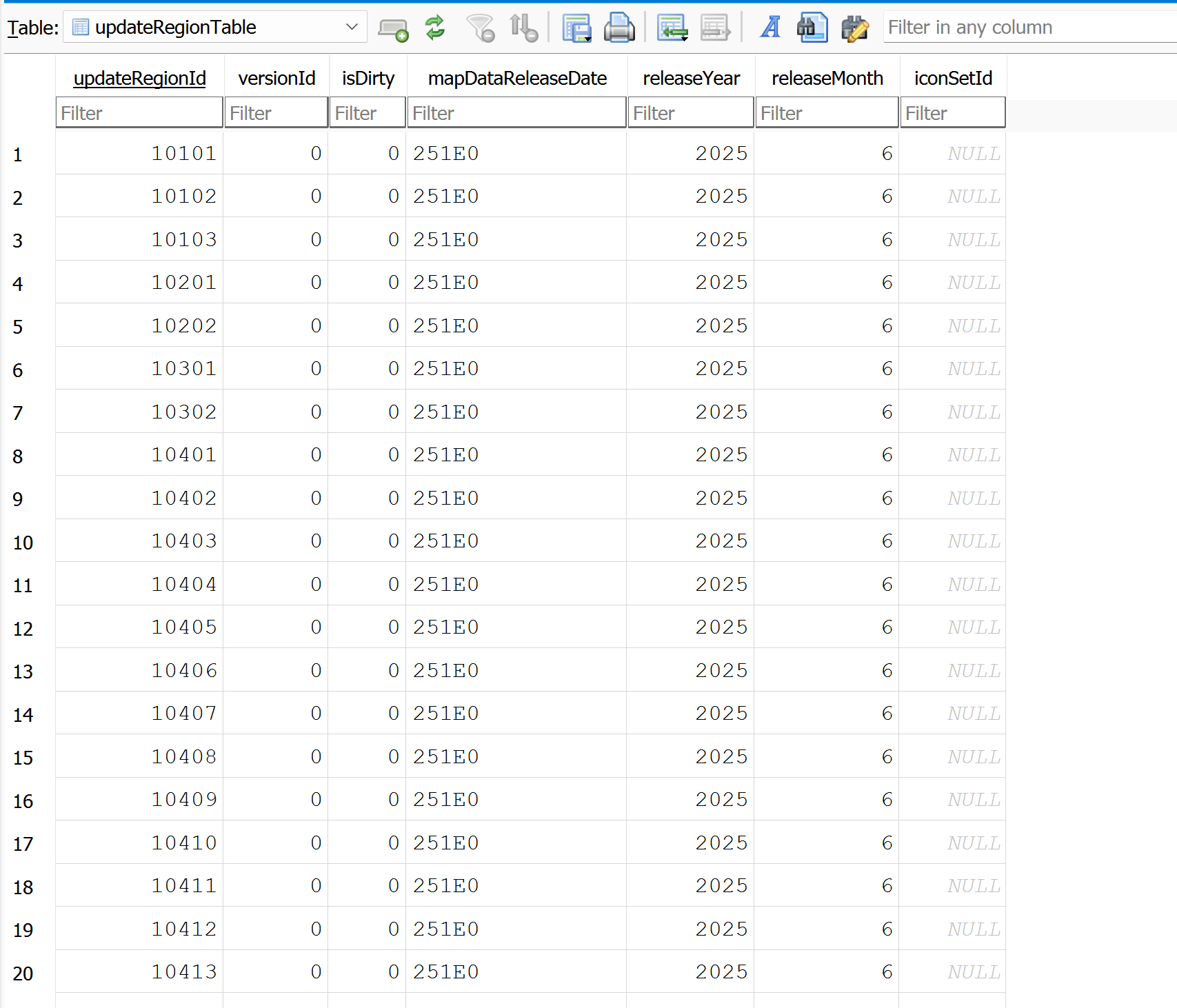

The 202525 is inline with your other post for 2025.02 so assuming it unzips fine and no mistakes by Vag should be fine. I'll inspect for 2025.02 in the file later. Leave you to test since I don't have mib3.
Edited by Tell
tidy
@MartinB
OK using that method to look at the files it's actually 2025.06. So it should come up as that once loaded if loaded fine.

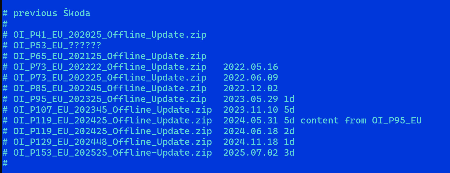

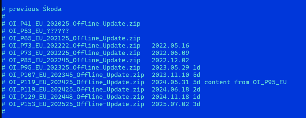

last underline has been "jumped up"
that were the reason of guessing script fail
I'll let you flush out the rest.
