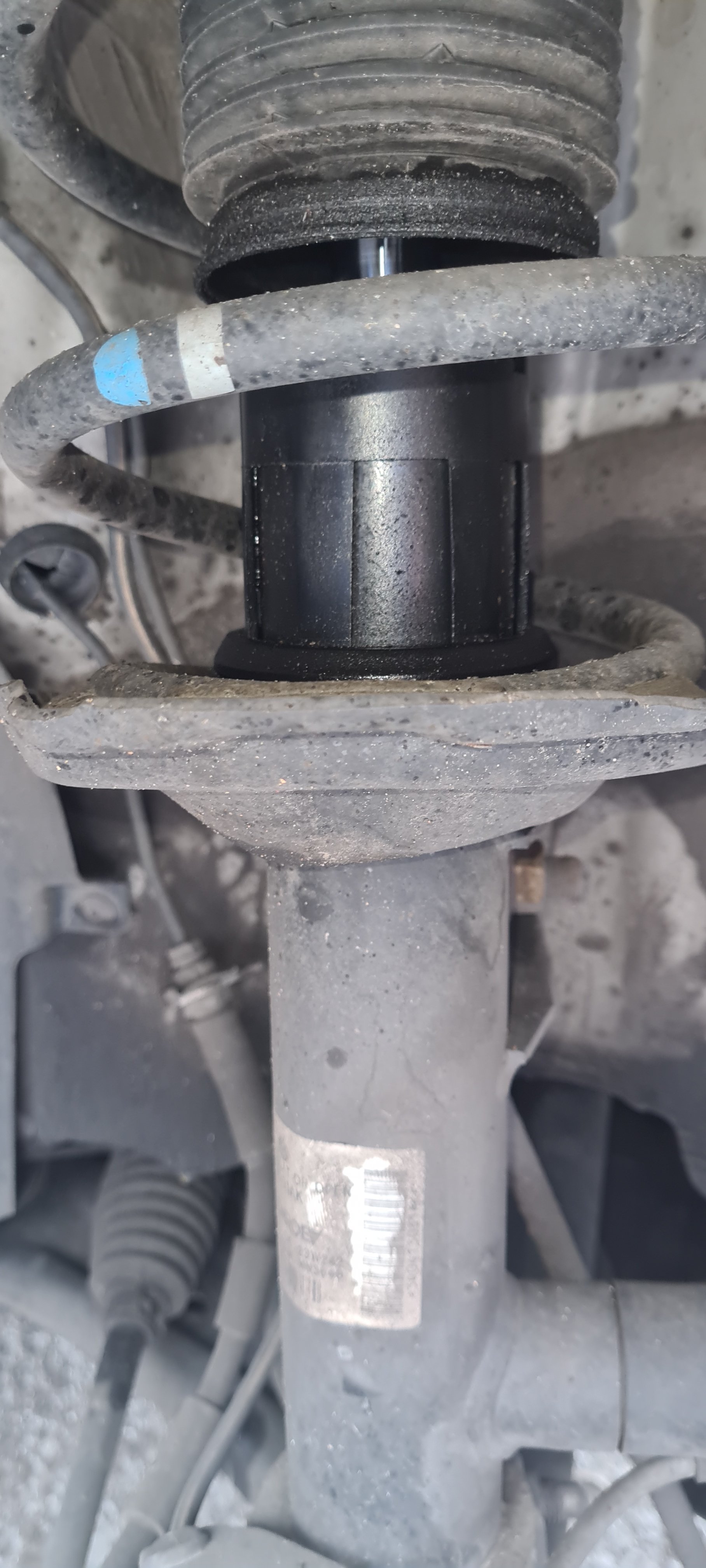

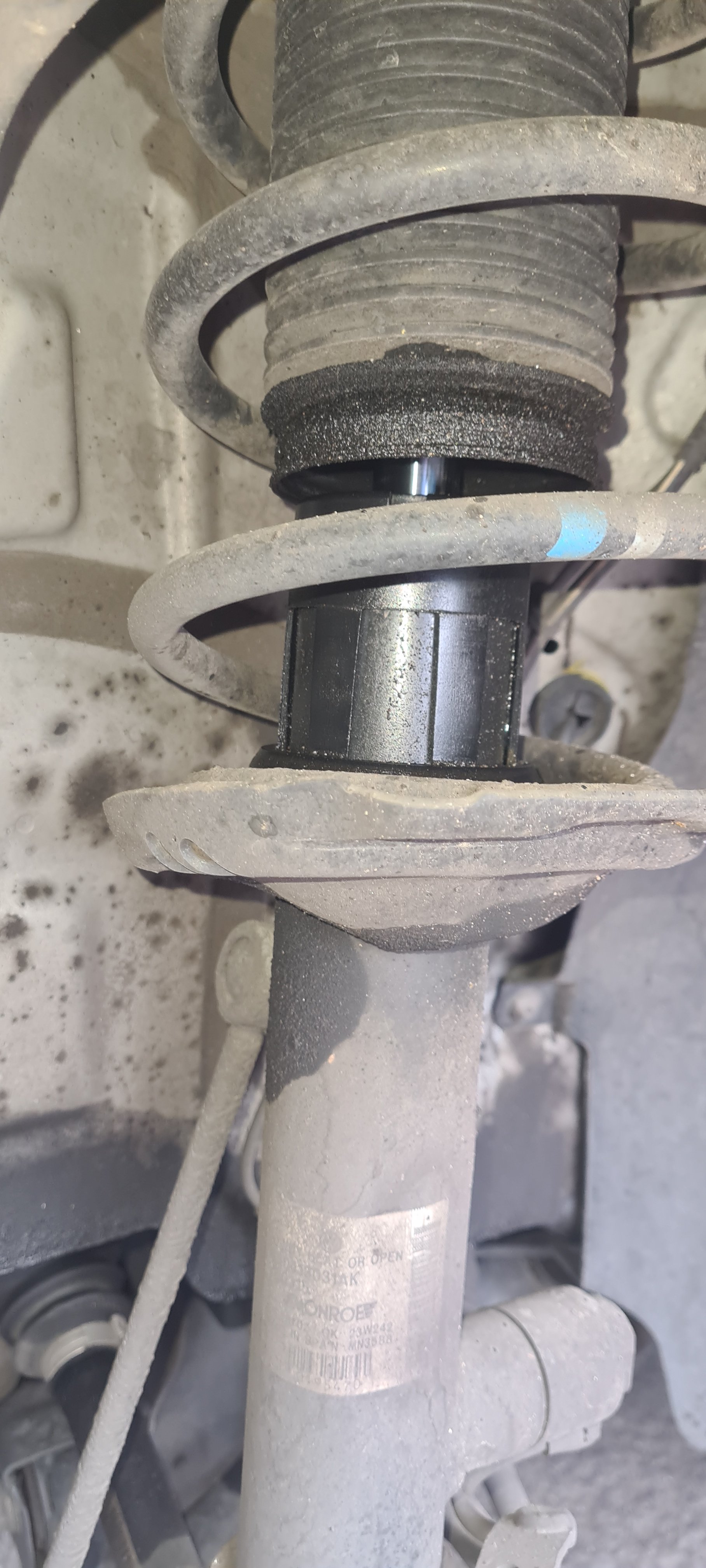

Im staggered that both my front dampers have started to leak and these aren't cheap .

There are the standard OE shocks on the 2023 L&K estates ( these are both front ) Monroe shocks a lifespan of between 50k - 80k according to Skoda .
Mine was spotted leaking at 68k but i think it started early 60s.
Awful shocks most of my milage was 80% motorway as well.
Will be replacing with Bilstein B4s very soon cost over £700 quid for the pair .

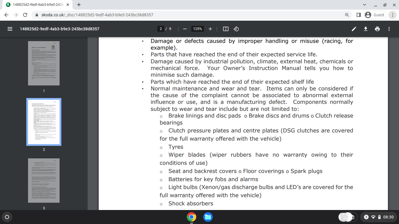

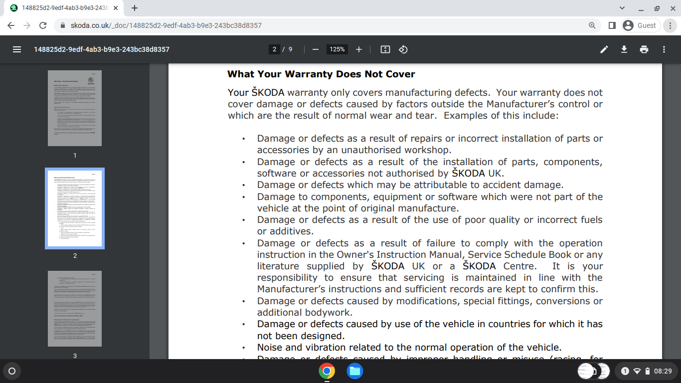

Being out of Warranty is not relevant when Skoda Warranty T&C,s exclude shock absorbers.
