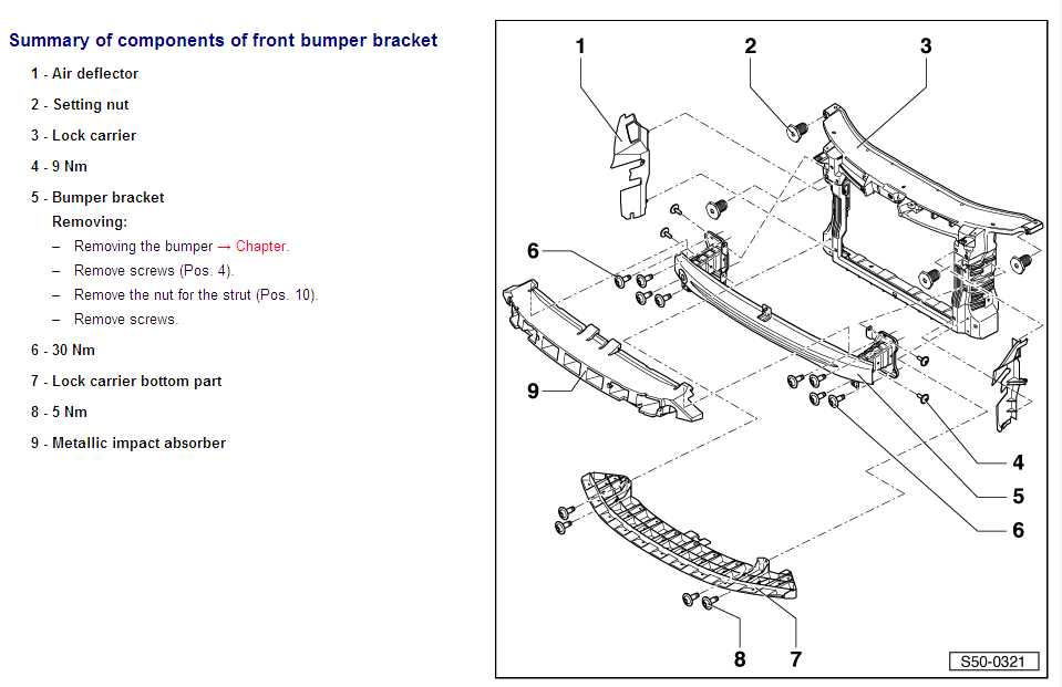

Hi all. Does anyone have a schematic for how to remove the lower grille? Or, failing that, how to remove the upper grill and foam block to gain access to the back of the lower grille?
