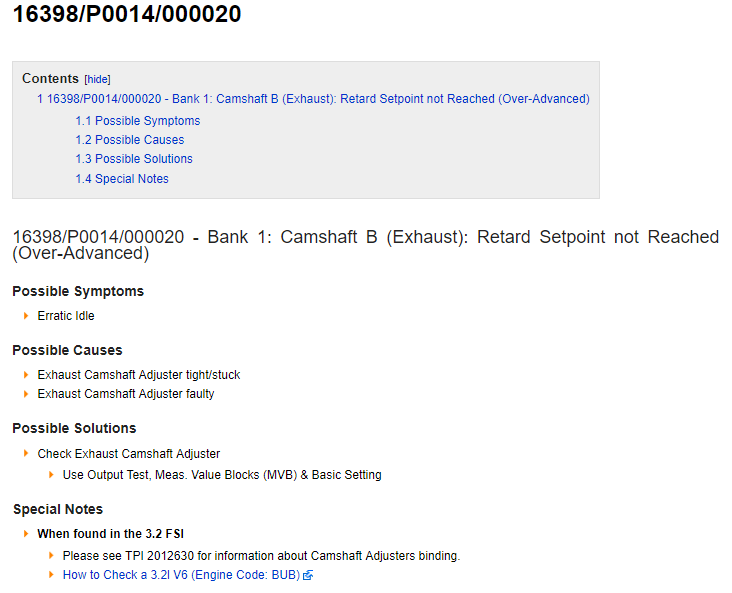

P0014 and P0011
15 February, 2019
7 yr
2009 Skoda superb 3.6 V6 has come up with these error codes. Cleared them down. drive car and no codes however when you floor it the codes then reappear after a few minutes. Any ideas what could be causing this?
