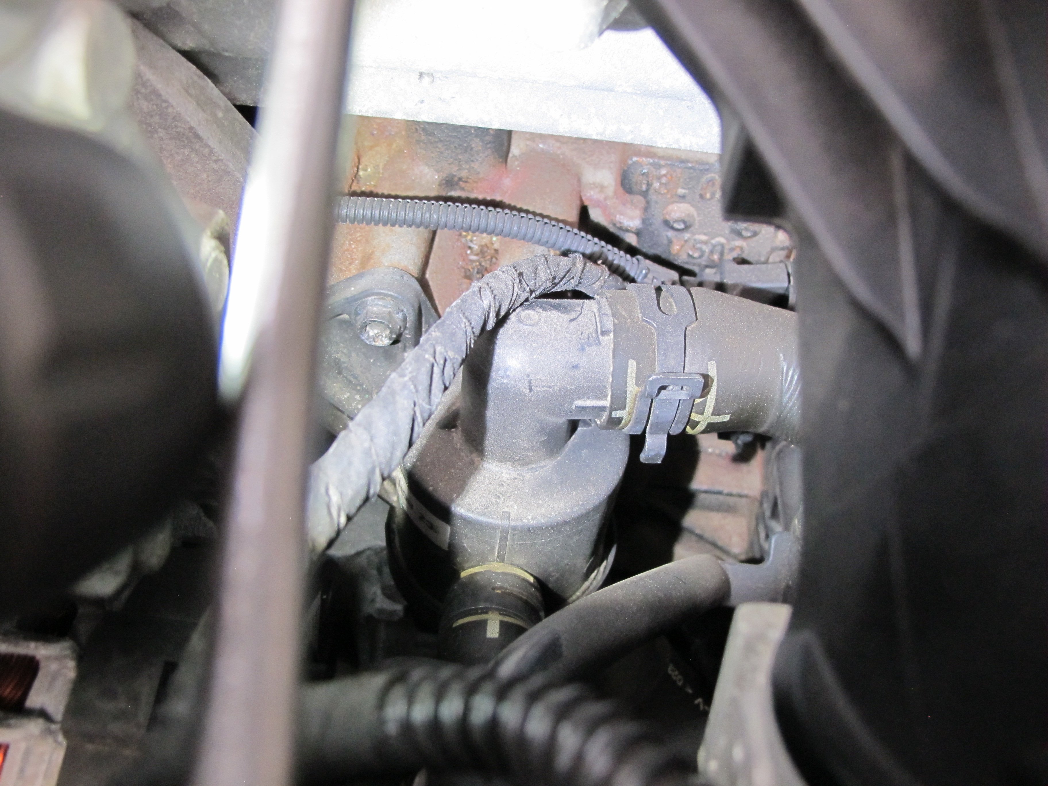

My Octavia Scout refused to start one day at the end of June with the glow plug lamp flashing. I traced the problem to Fuse 14. This fuse is labelled Ignition and supplies the fuel metering valve (N290) and fuel pressure regulating valve (N276). There were no problems for three months and about 1500 miles when it stalled again after travelling about 200mtrs. Replacing this fuse rectified the problem and the engine started and has been OK ever since.   The standing current through this
