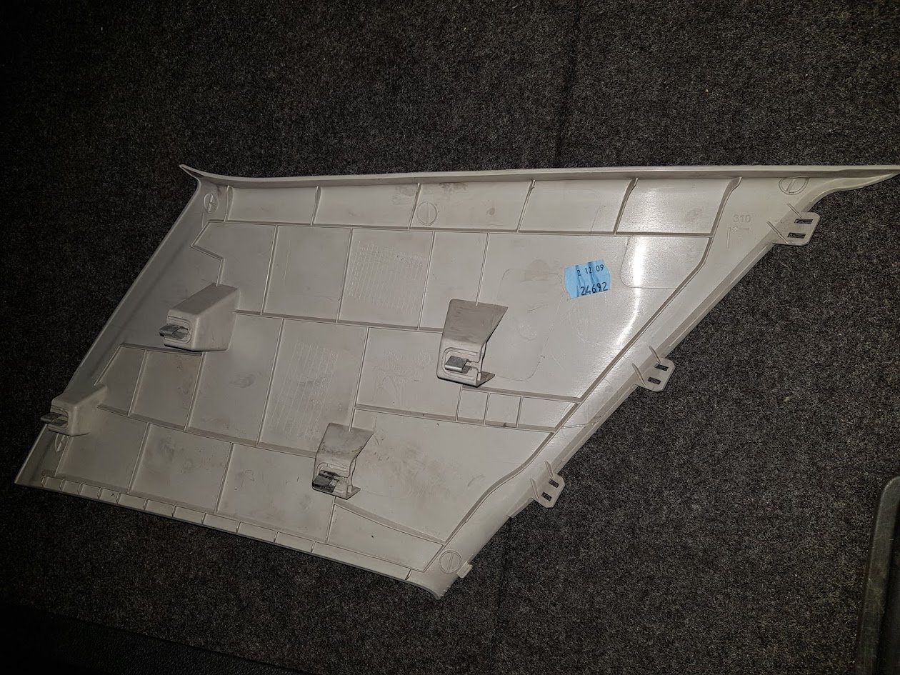

Hello, in my Superb I noticed that torch is not firmly fixed. Therefore I decided to remove plastic panel to check the reason for that. I thought that this will be easy job, but I was mistaken.   First the plastic from C pillar need be removed. Simply pull it off.   Than 8 bolts need to be found. 4 of them are located behind hooks (bellow is photo which shows locations). To remove 3 small hooks (marked 3,5,7 on photo) the hook need be pushed inside and than lift. T
