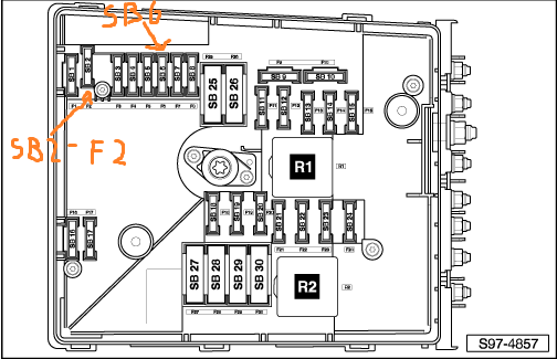

Check this fuse if you have this problems.
the clock and trip counter reset back to 0 after the engine is switched off
the fuel and temp guages both flicker up and down when ignition is switched on and then settle and proper level
