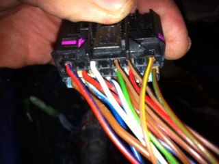

I need some advice as my 2003 superb is dying electrically. I got the dreaded water ingress problem and seem to have fixed the leak. I am now trying the sort out the problems it has caused ...

I have taken up the carpet, taken out seats etc and can see there is bad corrosion on the loom which is no doubt the cause.
so ........
-The block connector that plugs into the CCM has a wire fully corroded and no longer connected (not seen in picture), thus meaning that should fix one the the problems ... Can I buy a new plug, some how switch them over ?
-Even if that was possible, and i re soldered all the exposed connections in the loom that are rusted , is it possible the inside of the wires where i cant see is too badly corroded?
-Can I buy a new loom ? would that be expensive to buy / fit ?
