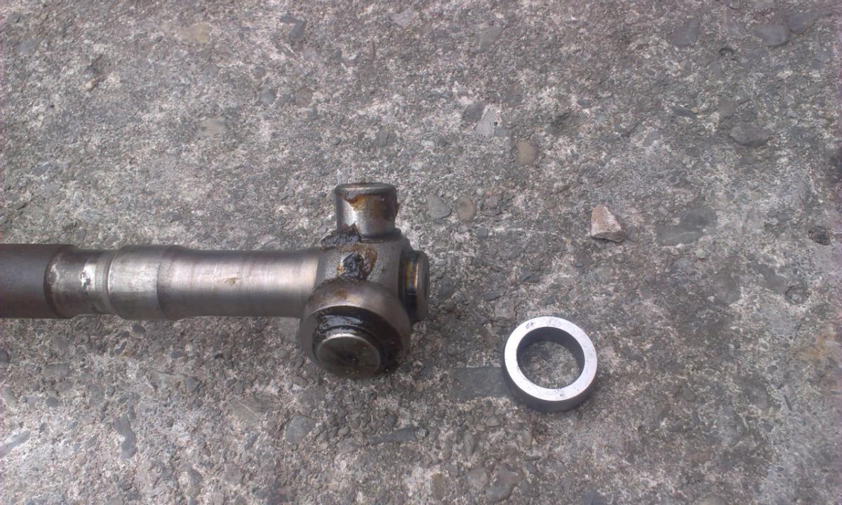

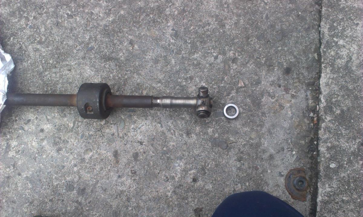

Yesterday i tried to pull away from the traffic lights at work and the offside DRIVESHAFT fell completely from the car. I got a very helpful neighbour to tow me home.
Now if anyone would kindly guide me through the process of repairing my car i would be grateful. I have the driveshaft in my boot but the circular washer type things from the inner end (sorry) have come off and subsequently a load of the little bearing pins have fell out.
First question is would i need a new Driveshaft? The other question is as i have done a few jobs myself, but am still a total novice, is it fairly simple to replace? It doesn't look like the toughest of fixes...

The driveshaft has come off and at the inner end of the shaft there is a load of tiny bearing pins underneath a washer type thing. Are you sure these are to do with the gearbox? I may sound thick here but they look like they would just be on the end of the shaft?
Pictures tell a thousand words.
Ok i will go and take some now. Thicko didn't think of that first....BRB
Let me know if those pics are ok.
The only problem i seem to have is the little pins underneath that washer type thing. Otherwise the shaft looks ok to me..... :sweat:
Ah yea ok, the inner tripod joint has separated and fallen apart... Not the end of the world, the gearbox will be ok, at first i though you meant it had pulled out the box...
any who, there will still be a portion of this stuck in the gearbox, you will need to drain the oil out of of the gearbox first before trying to pull this out. You will need a lever bar or a crowbar to remove this from the gearbox, it's only held in by a circlip.
that shaft is probably ok to use again, you can buy an inner joint on its own, but it would probably be easier to get another whole unit, it also looks very dry, there's been no grease on that tripod, that's probably why it's broken.
