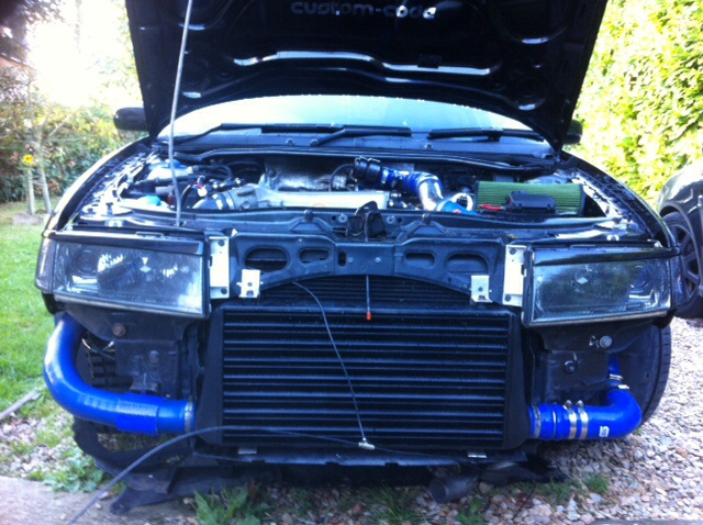

Not a great photo..here's mine.
Thanks.. I know two ways you can route it, but just wanted to know the pipes you guys have used so I can get things ordered and get this big old cooler fitted :)
