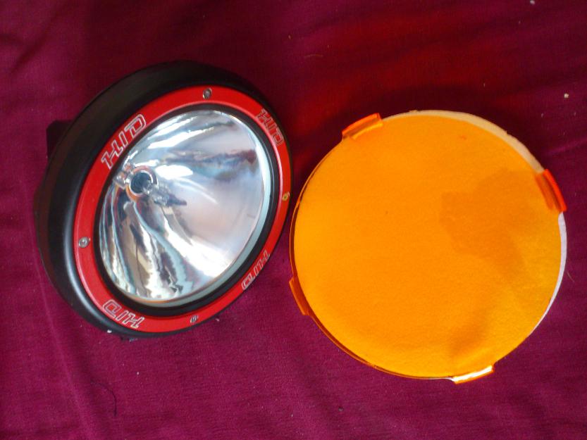

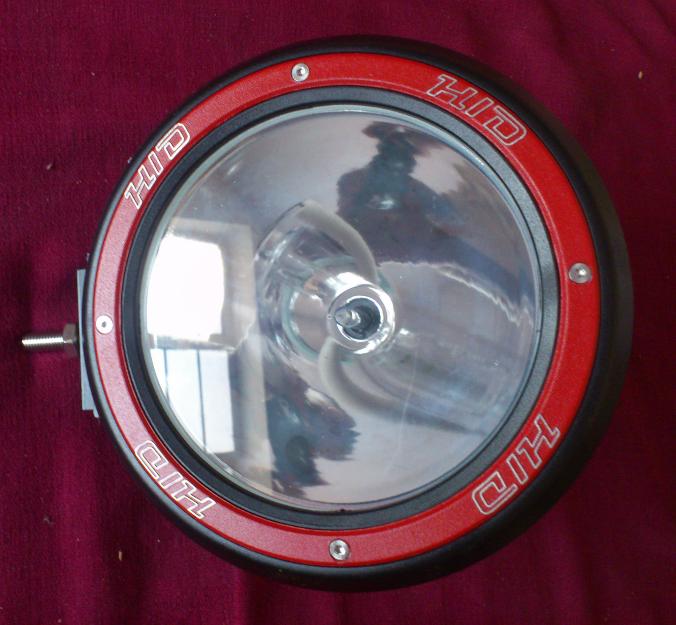

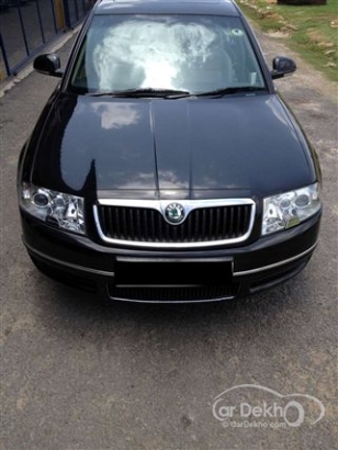

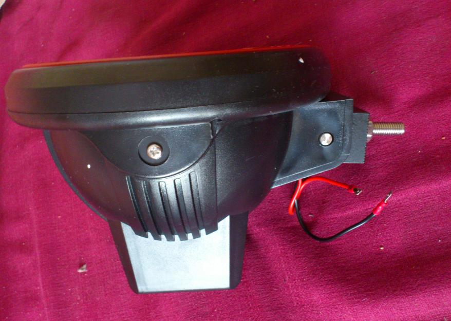

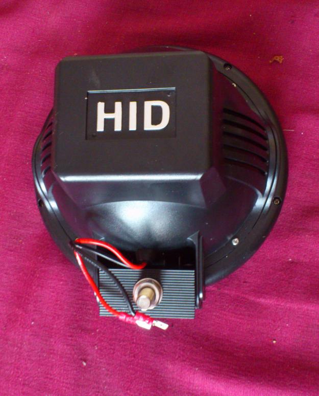

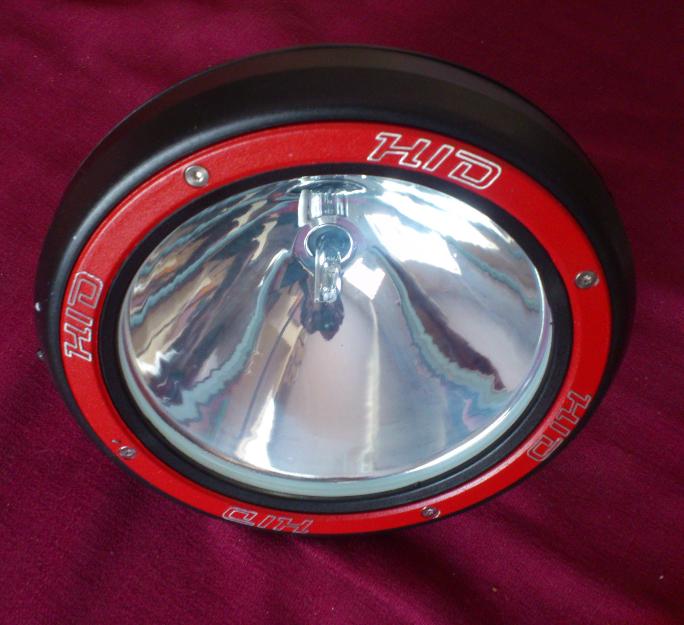

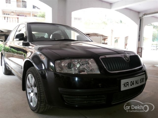

Dear all, Tried hard to use my halogens in the skoda superb I, but they are not adequate for the country side roads here in Karnataka-Goa sector roads in India. Looking forward to fit a HID 35 W Auxiliary bulbs which i am getting it at a decent deal, USD 120 for a set here in Bangalore. I am attaching few pictures of my car, and also the lamps here. I need advice on following. A) how to mount the HID lamp ( if any one have done it in past, please share) B ) How can i draw power to this lamp without affecting CANBUS C) Does this affect my car electrical system any way. The specifications are as given below, Brand new 7" HID 35 watts Auxiliary lights, can be fitted to any car or jeep .The ballast are internally installed,100% waterproof Light Specifications.. Out Power: 35W HID Bulb: H3 Operating Voltage: 12V Working Temperature:-40?- 80? Optional Color: Black Shooting Distance: 800 meters Ballast: internally installed Material: Aluminizing light cup, Toughened glass Luminous: 3200±400lum Beam: FLOOD Beam 3000 hours above life time Dimensions?7 inch Two wires simple installation Shockproof Specifications: 205X155X250MM

I did change all the headlight bulbs for 55W HID when i had it. The wiring is only 1 carats, that's why the halogens are horrible bad. Also why you need new wiring directly from the battery. But then it's pretty straight forward. Remove front bumper and headlights, then install ballasts with HID bulbs etc. Adjust and enjoy. You would only need to remove the CANBUS check for the headlights to get rid of the annoying BEEP sound which will appear after.

Fitting HID in to an existing projector lamp is not street legal in India. But many people do and manage to pay penalty whenever traffic cops stop them in city. Whereas separate HID can be used only in outdoors where there are no traffic from opposite side. So i am trying to use this lamp only in six lane highways or in country side road where there are no traffic from opposite side.  I have not fitted the lamps yet, that's why i posted the query requesting people to suggest how to fit it...
