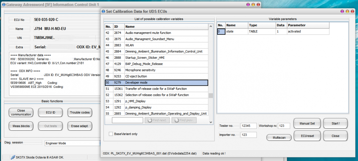

As per the title, who is suffering from DAB dropouts on Estates with Columbus or Amundsen? I know there was a thread a while ago, but can't find it on my phone :( It looks like I have a fix, but it needs VCP to do it. I have found some settings in the hidden Green Engineering Menu that have fixed it for me (no Jimmy jokes please). I spoke to my contact at Skoda today and I'm sending them some details across, hopefully this could result in an approved Skoda fix eventually. Anyone suffering f
