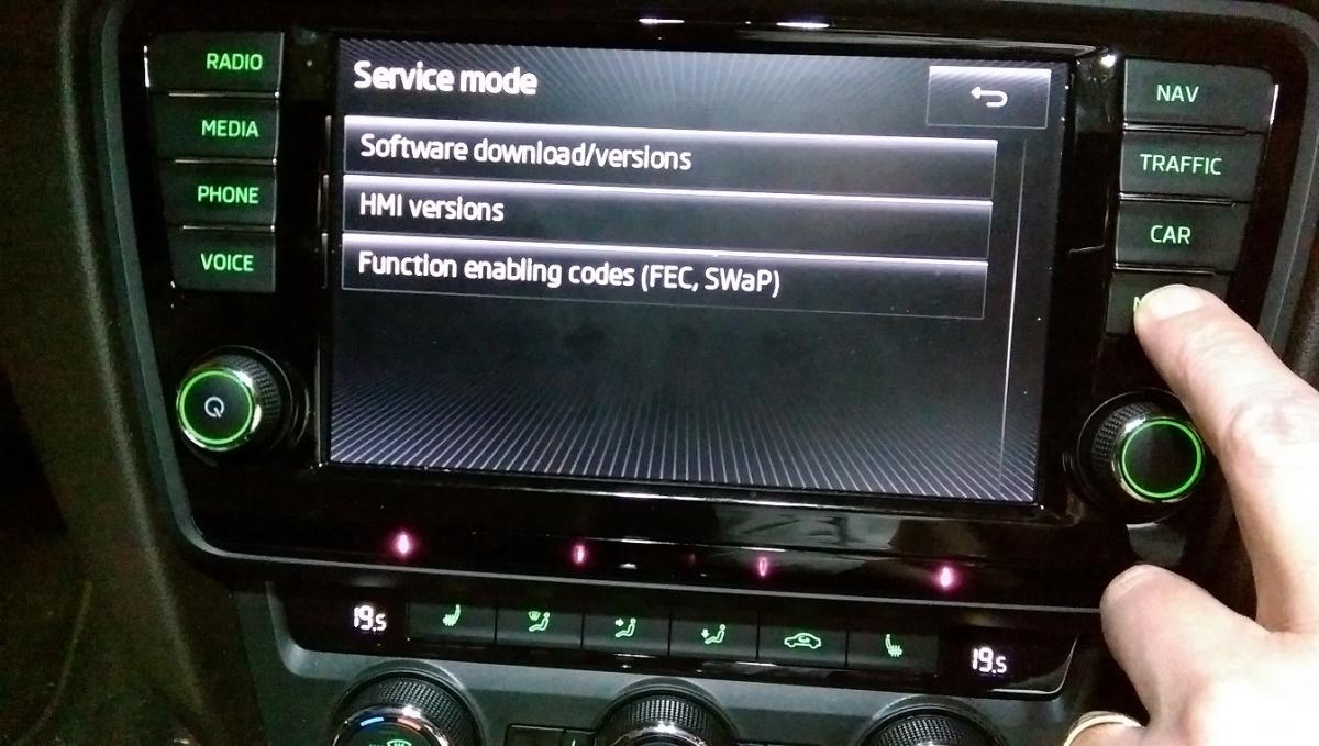

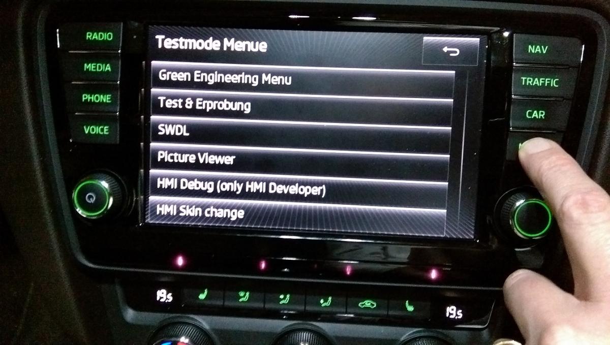

Next, access the Green Engineering Menu by holding in the MENU button for about 20 seconds. You will see the Service Mode menu – keep the button pressed
Then the Testmode Menu – release the button and select Green Engineering Menu

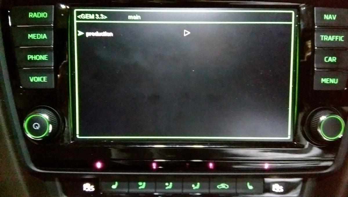

The Green Engineering Menu then comes up. You use the right hand wheel to browse up and down by scrolling, and select by pressing.

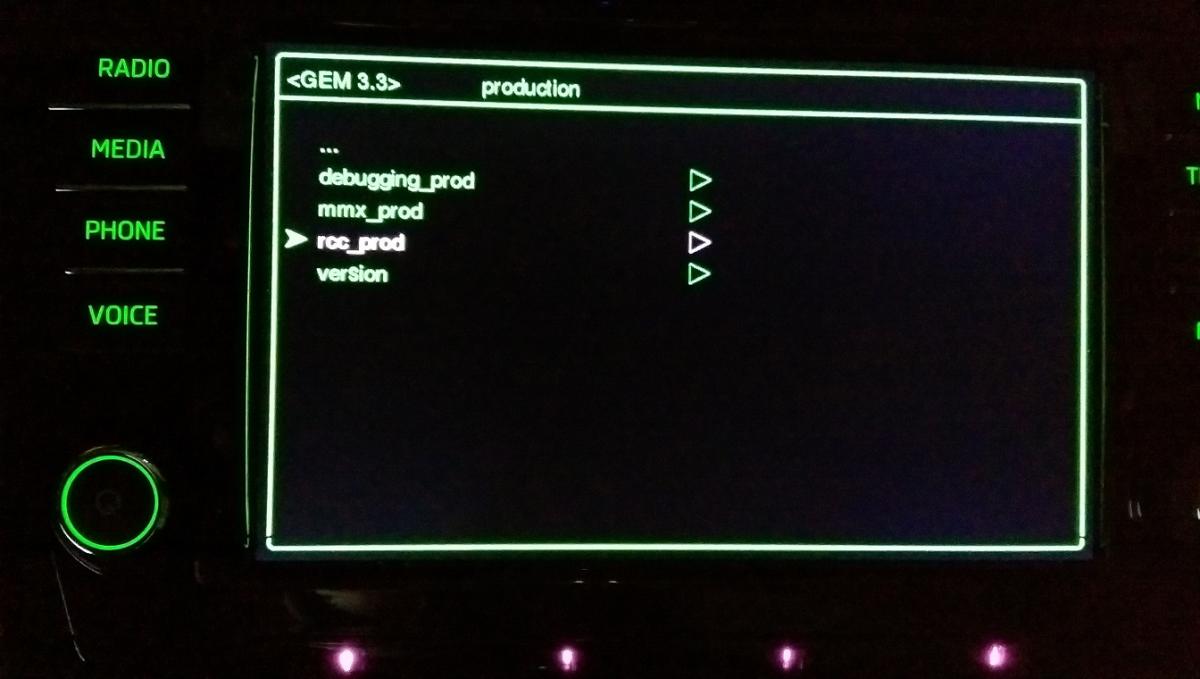

You need to navigate to the following path:
Production
Rcc_prod
Radio_prod
Dab_prod

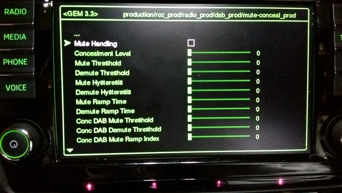

Mute-conceal_prod
At the top of the screen you will see the following is selected
Mute handling
Press the right hand button to deselect mute handling – this is reversible - I will post the method soon. If you disable it then re-enable this all the settings are at zero.
 I tried changing the settings for the Mute Threshold and Demute Threshold but unless it was turned off completely I was still getting dropouts.
Then scroll up to the 3 dots and press the right hand button to go back a level, keep repeating until you get back to Production
Then press Menu to return to the normal MIB Menu
You have now disabled the Mute handling for DAB.
