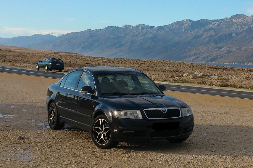

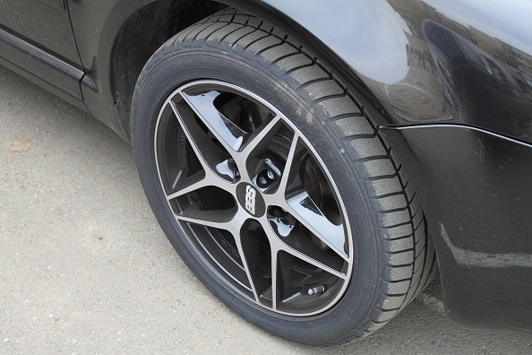

That's how I ended up with my summer rims BBS CF 17" looking like this:
A word of advice, besides the looks, try not to go over the top on the size, mine are 17" and I can tell you that the ride lost some comfort compared to the 16" original alloys that I have for the winter season.
Depending on the condition of your roads, I think 17" is already at the edge of comfort/looks limit.
Happy hunting...
Is the offset right on those wheels? They look to stick out way too much from the arches. ET37 is "correct" on this car (ET40 for the winter wheel).

They are ET35, a tiny difference from the standard. From what I know, any difference of up to 4-5 mm from the standard offset does not imply any functional issues.
Furthermore, in reality they do not look to stick out from the arches at all, maybe the angle of the photo plays some perception tricks...
