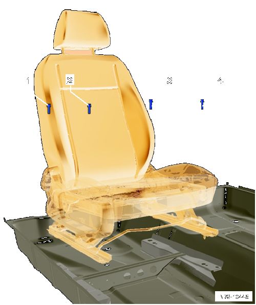

So, is it? Just want to give the carpet a good clean.
Service manual chapter 72-
1.1 Removing and installing front seat
Removing:
– Put the seat into the foremost position by means of the longitudinal
adjustment.
– Unscrew the rear screws -1 and 3-.
– Put the seat into the rearmost position by means of the longitudinal
adjustment.
– Unscrew the front screws -2 and 4-.
– Remove seat from vehicle.
Just don't forget all the cable spaghetti especially if you have side airbags (careful with static electricity) and electric seat / heating, etc..
