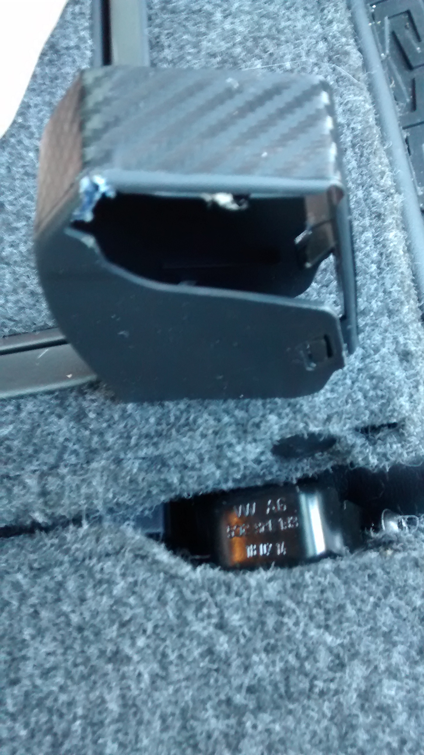

How to completely remove rear seats on the O3   Difficulty 2-3/5 - harder than it looks and clearly not easily designed to be removed - ( shame on you Skoda get with the 21st Century already ! Cars of the Citroen dogger/serial killer wagons type having been allowing easy seat removal for years ) The seats on Octy though to fold pretty flat, so I imagine maybe they don't expect it and not encouraging people to easily change their seats or clean them....   So; Se
