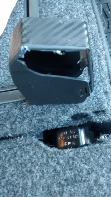

Seat backs: More difficult.

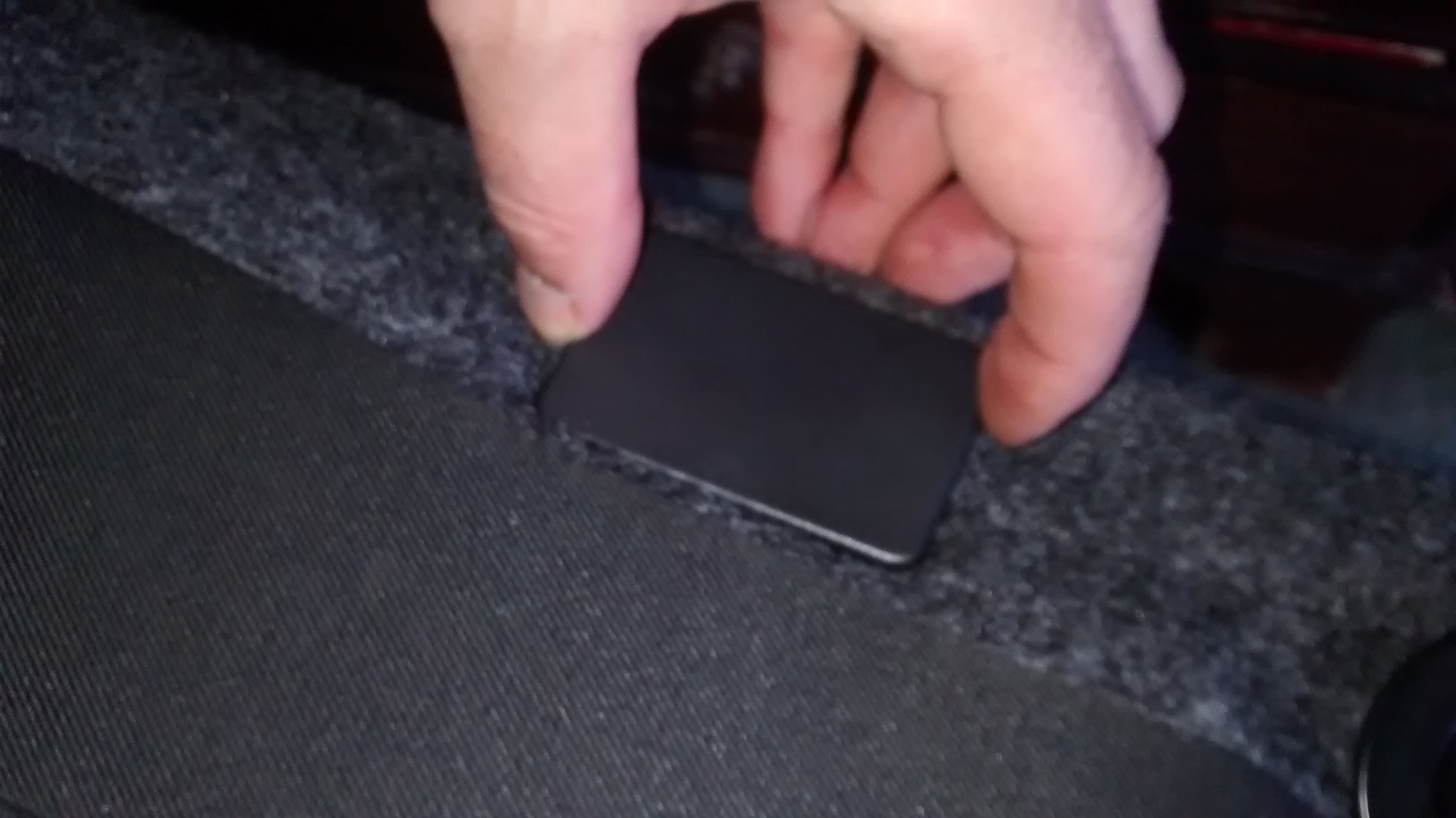

Fold down both seats right down. and in the split that is quite tight between the 2 sections there is a flimsy plastic cover. its barely possible to access and will likely break, but it sort of folds on itself so should unclip. To be honest I'd be tempted to throw the crap cover away but I refitted mine with some carbon tape over it.
The cover surrounds a L shape bracket that is held in place by small spline socket bit, that is typically in most toolkits. ( there is also something in the rear boot as a special driver, I think might be worth checking? I was surpised VW gave away this special tool in the boot rather than screwdriver, must be a reason).
Unscrew the spline with the correct spline bit. Sorry didn't check size but it should be fairly common one as its small.

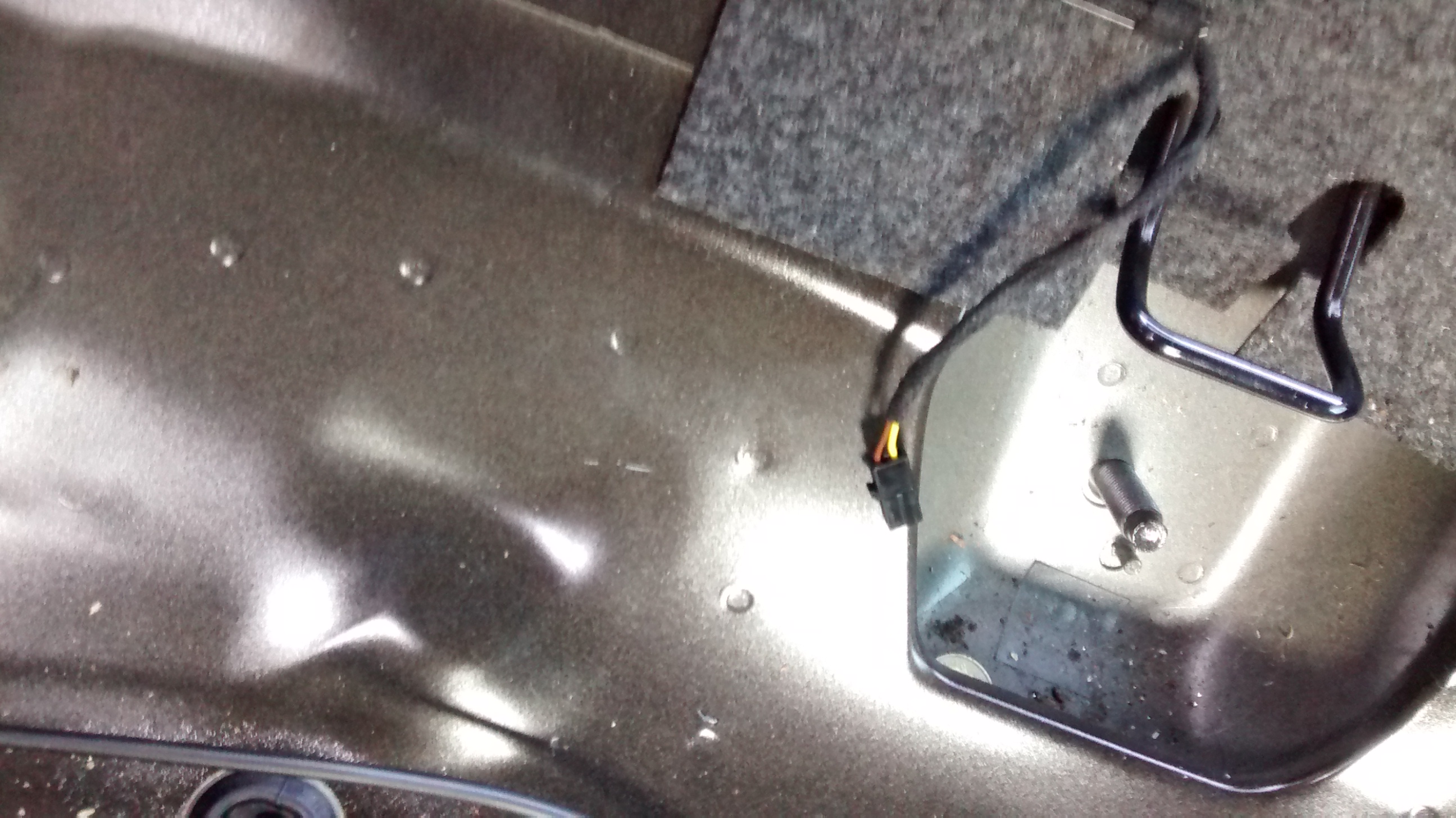

Now both seats will free to be removed from their central mount which then allows lateral movement on the far sides to release.
They can then be pulled free sideways from their side mountings but be aware will still be attached to remote release cables and on the bigger section, to the seat belt mount and sensor cable to check seat is plugged in (don't damage it!)

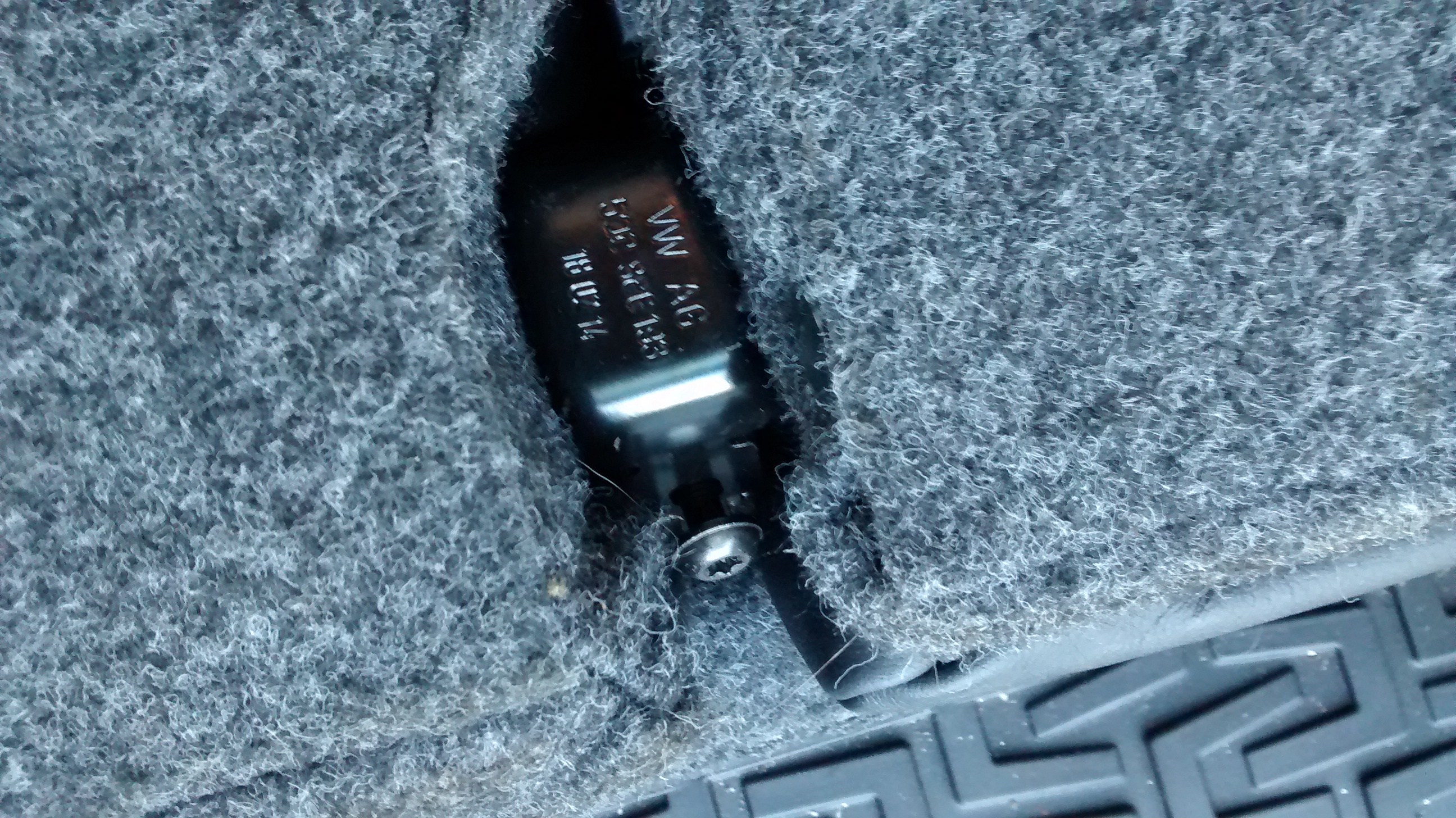

Now unscrew the seat belt mount on larger rear back, its about 20 size socket IIRC correctly, its quite big.
The wiring connector should be first freed from its mounting ( compress to release). You can then see that this unslides from the wiring connector and the 2 part connection itself can be lightly seperated by lifting the small tab lightly to seperate the male part.
Thats it - your seats are free !
