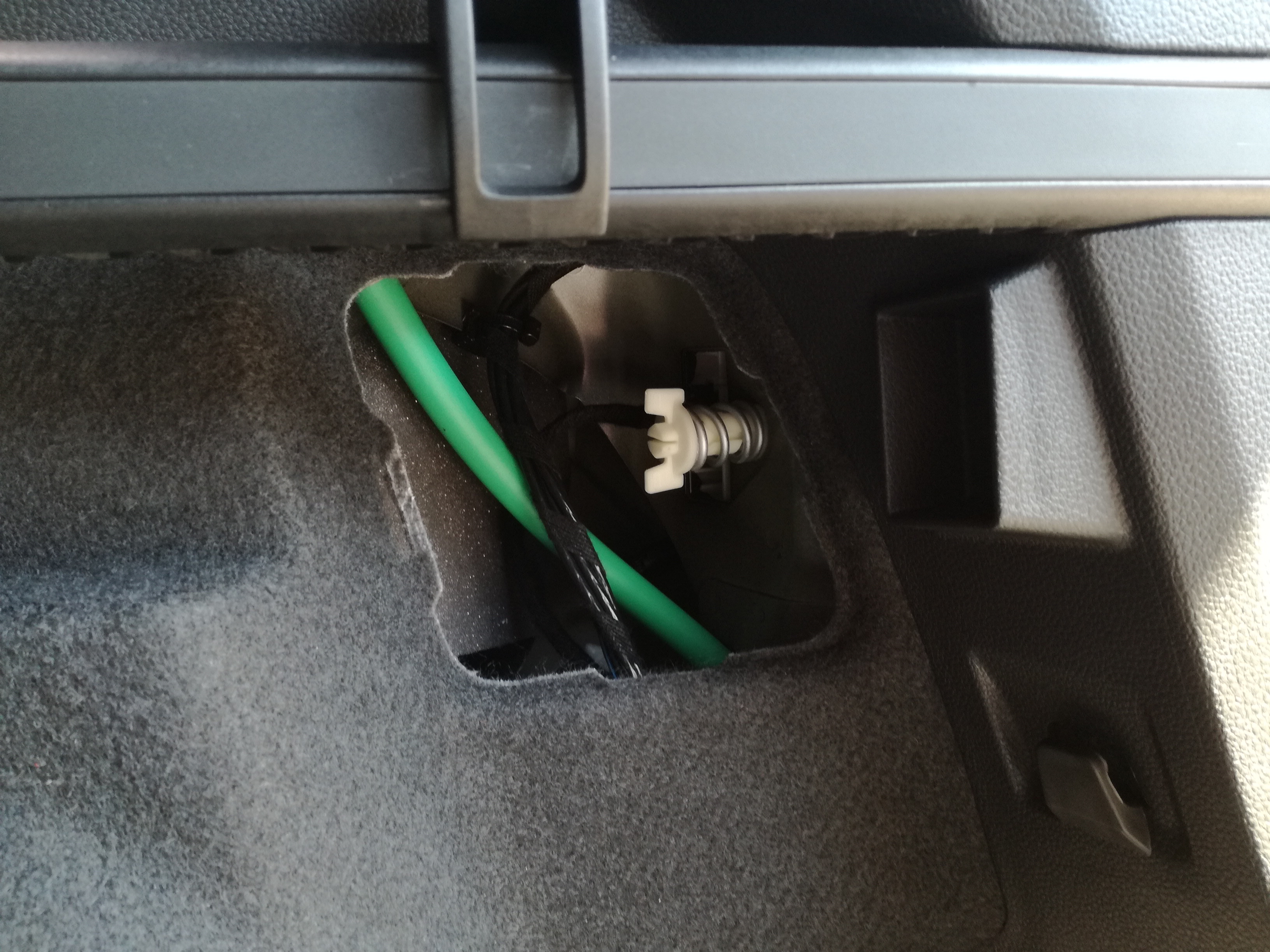

This is a nice easy mod to make the whole rear lamp cluster LED. The front and side indicators are LED already so this makes everything match. Also the reversing bulb is much brighter and not the yellow halogen colour.   Step 1. Take off the side panel to access the back of the rear lamp. There is a big white plastic screw which needs to be undone all the way. Then the lamp cluster just slides out.   Step 2. The wiring harness is held in with a red plastic cl
