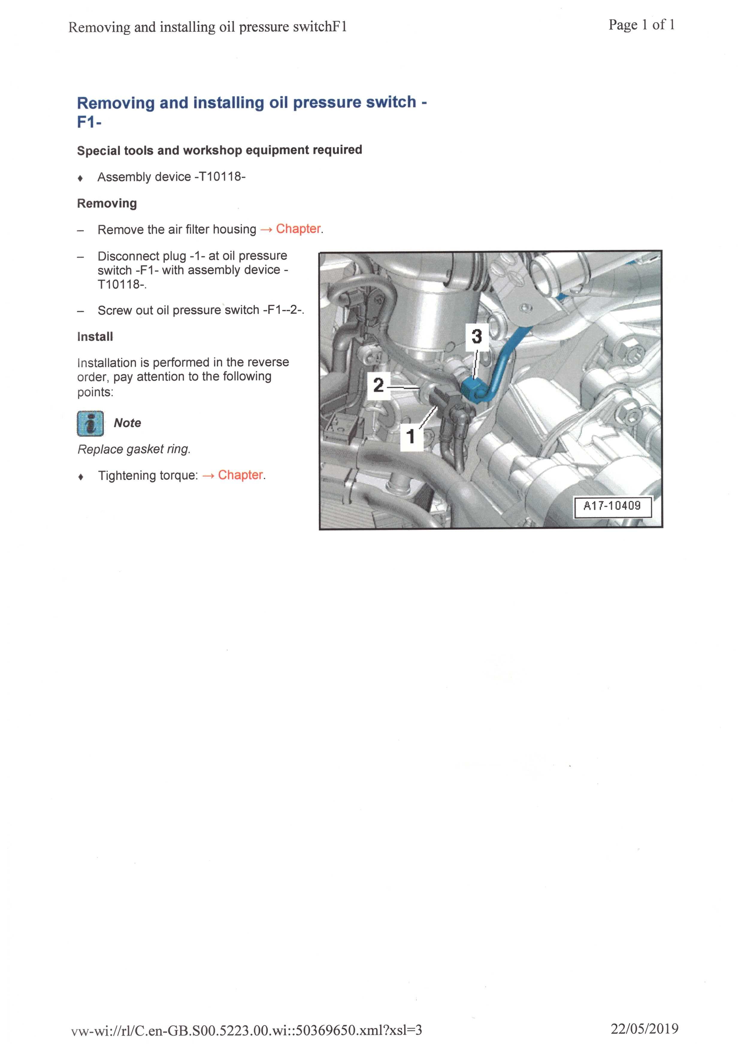

Hi all   Have what I believe is an issue. On startup, all the usual warning lights appear, but no oil light. I'd expect a red oil light with ignition on, then quickly extinguish once the engine is started.    This is not the case.    I've done a forum search, but no answers. Any ideas?    Cheers Scott
