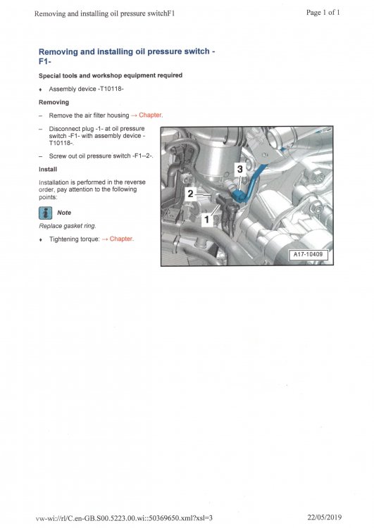

You could try shorting the wire going to the pressure switch to ground, that should put the light ON
Edited by nige8021
Thanks.
I don't have access to vcds, yet. But a simple short to ground is an easy test. To save a quick search, where is the switch located?
Scott
Isn't it the other way round Nige?
Shown as normally open on the circuit, which I would interpret as the condition when the engine isn't running. When oil pressure is good (above threshold), I would expect the contact to close, shorting the wire to ground. So disconnecting the wire with engine running would give the same fault indication as a real loss of oil pressure?
Edit: RPM may also need to be held above 1500 to see a fault light come on.  I seem to remember that on some models at least, the state of the pressure switch isn't monitored below this engine speed.

Hmm got me thinking now, if it is that way around there would have to be an inverter circuit in the speedo ? as surely it's easier to have the low pressure to switch a ground to the warning light ?
  • Sponsor
I'd expect the wire to go to a processor digital input that's pulled high by a resistor.
Best to design it this way round so that broken wire gives a warning, as well as real low pressure doing so.
Yeah I was probably thinking more of the old school warning lights
