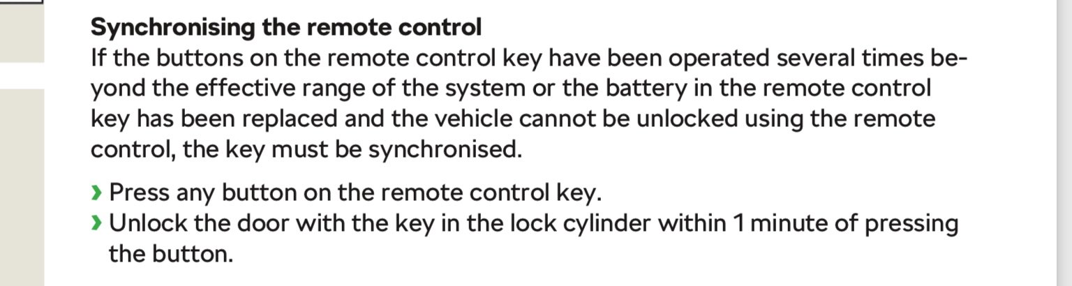

Can anyone tell me the sequence to reset a kessy key after putting in a new battery?

From the owners manual...
Thanks for your reply Kenny R. With the confidence of what to do with your information  I changed the old battery with a new one and guess what? The key worked straight away without anything else having to be done. So it seems that it is only necessary to put a new battery in and that is it.
Thanks once again. 👍
