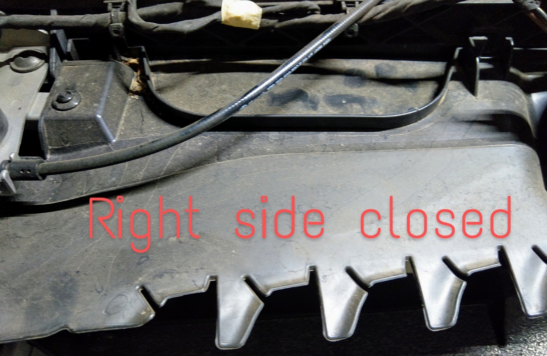

For those of u who have heard of the MK7 Golf GTi Intake Mod, I did a similar thing to my Superb's air intake, by opening up the blocked off bits on the right side.    However, with the Superb, doing this alone won't be as effective due to the design of the front grille and the plastic moldings behind it.   The reason for this is because top half of the Superb's grille is actually blocked across, with air only allowed to enter through the bottom half.  This means the air goin
