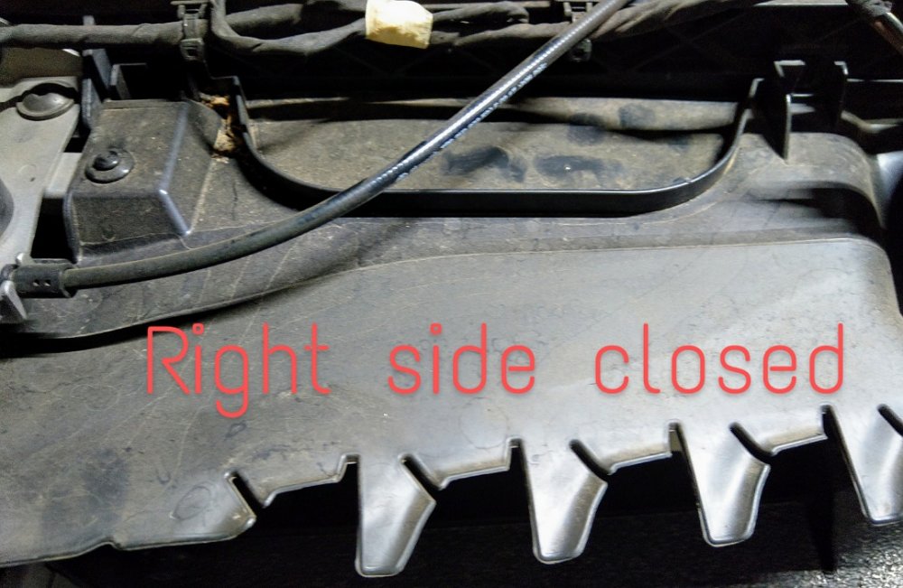

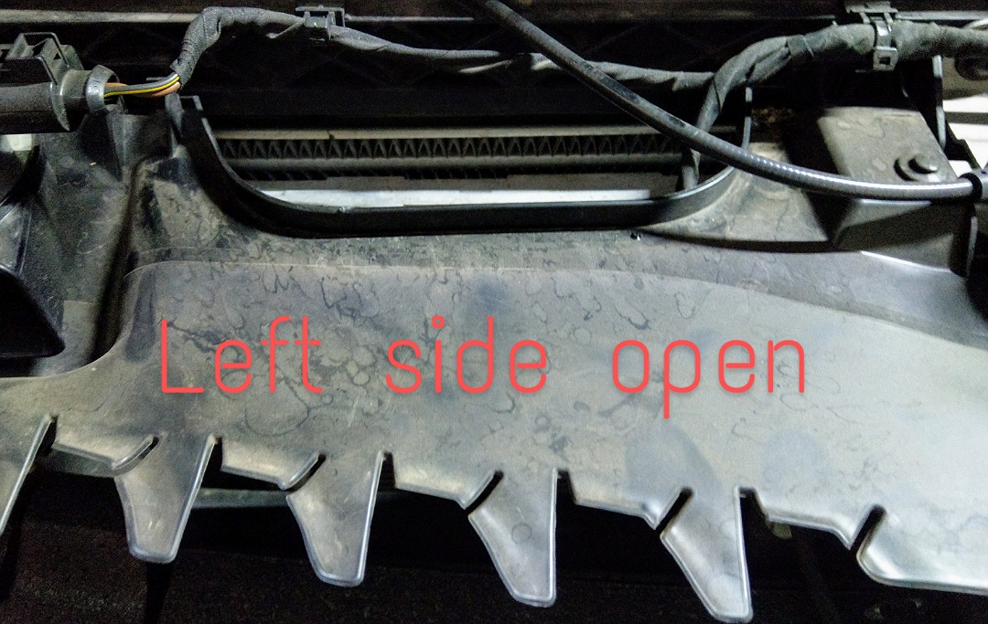

below are some pics.

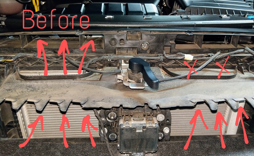

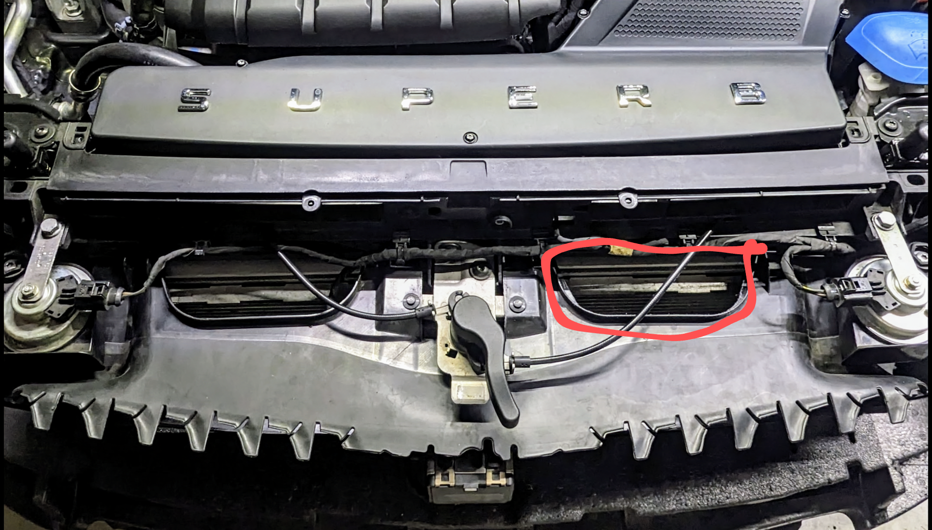

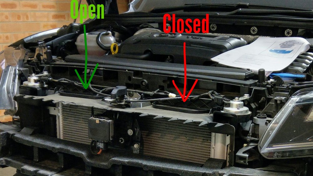

this is the bit i'm referring to - from factory the right side is closed:-

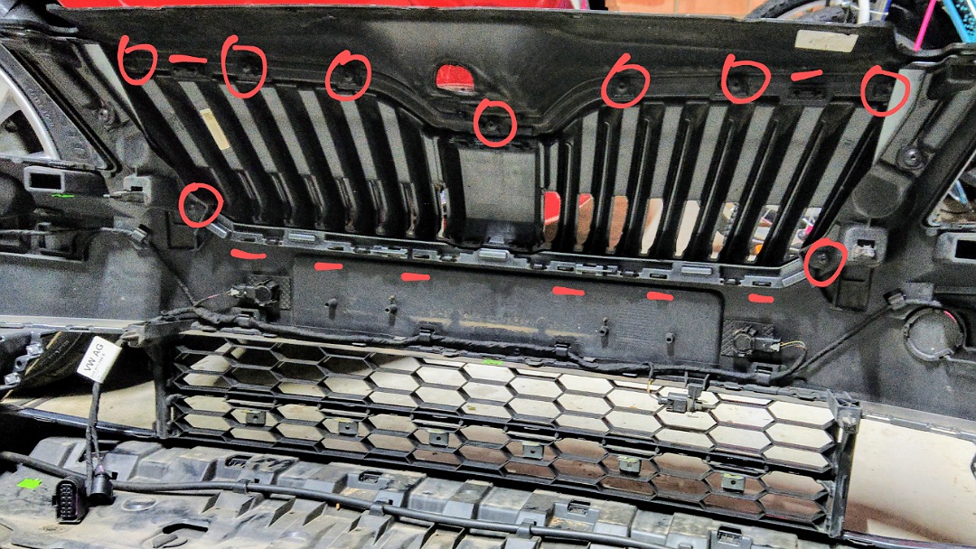

@TheBinarySheep- here is pic of behind the grille.
Not an easy task.
U can see all its mounting points.
Circle = screw
Dash = clip

At the top of the image, there are two clips and 7 screws. Once those are undone, the plastic above the grill under the bonnet should come away. I've managed to get to six of those screws and the two clips. The middle (final) screw I think can be accessed through the pop-off bit in the grill in front of the radar sensor. The sensor needs removing though which is risky.
It's either that way, or whole bumper off job.

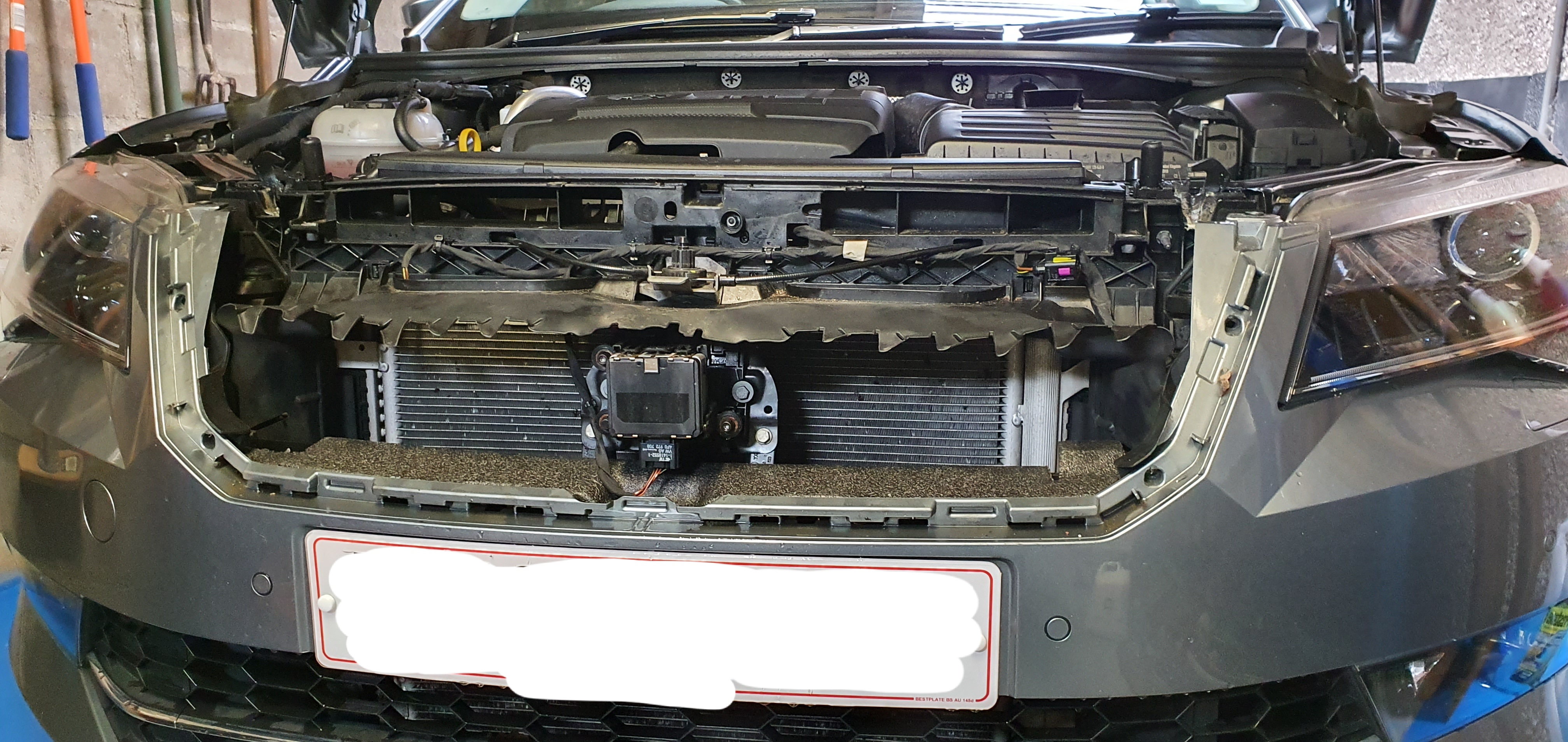

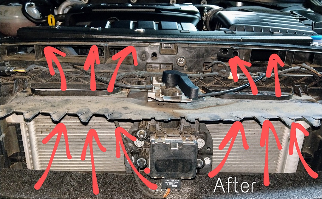

I don't want to disagree with anyone, but attached is the access available with the grille off. I went nowhere near the ACC unit. Granted I wasn't going near the air intake either though so I'm not sure if things would be different in that respect.
On refit, I didn't use all the grille screws. I don't think I put the bottom ones in. They kind of went overboard with their fasteners and clips usage!

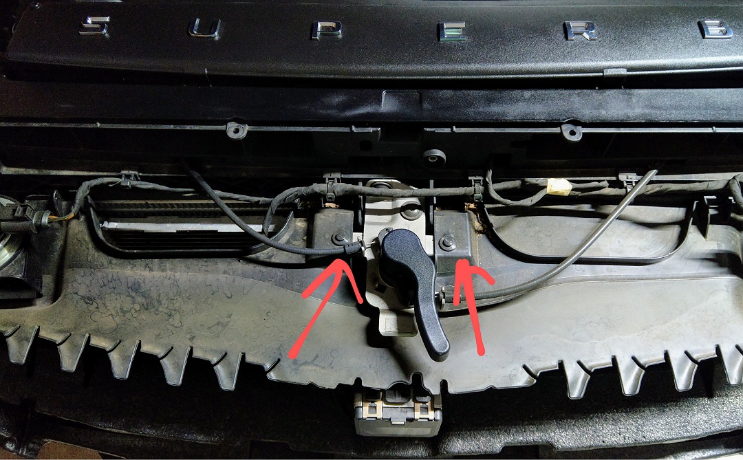

I'm a bit fuzzy on remembering the top one...have you removed the bonnet release mechanism? A clip slides out and you can lift it off for access.
Let me know, and if you've done that already, I'll go out and have a check to refresh my memory.
ah, I've not released the bonnet mechanism. I'll have a look at that tomorrow sometime. Thanks.

by the looks of that, there is plenty of room in and around that plastic flappy bit above the ACC radar :)

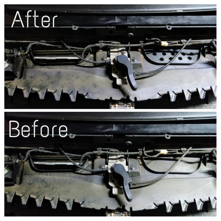

Not to resurrect an old thread but did this today. I found a brand new Stanley blade worked to cut out the plastic piece out completely. I didn't want plastic bits falling down in front of the air con condenser and it made sense to open it up completely like the other side.
I did it without even removing the grill, just squeezed a flexy lead with a T25 bit on between the slam panel and the black plastic upper, bit of a sod but worked. The central bolt was a **** but I didnt want to remove the radar as I know its very sensitive to calibration. Removing the bonnet handle is very easy, pop a little clip out of the back and it just lifts off.
I had done this basic mod on my mk3 Octavia VRS with zero issues in 2 years. On the Superb, there is even more of a rise up and over for airflow into the airbox so doubt there would be any issue short of submerging the car through a flood or river. Ive only cut out the central part of the upper intake, I have each side to do still and remove the snow grate.

Not long ago I dremeled out the opening properly - from the holes I had originally to fully open.
